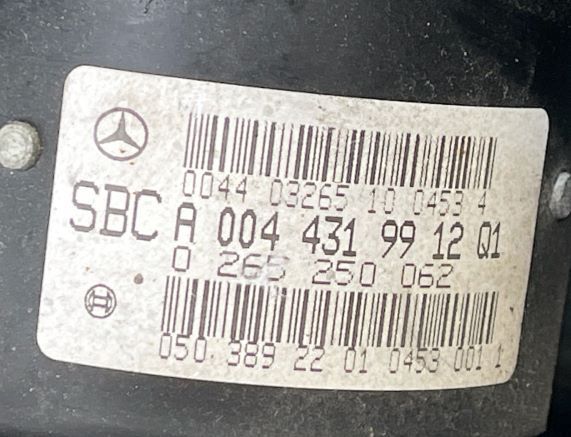

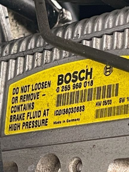

I am having part compatibility Issues!!! Could anyone Please help me.
I have a 2004 SL500 AMG package. also has the AMG brake system changeover. My ABS brake pump module has gone out and I am trying to fine another. I don't mind buying a used one with a warranty from a site like E-Bay but I can not find my part and also can not find the information that tells me which will work. I have read enough to know they are not universal to year and make... I have an
2004 SL500 AMG
VIN# WDBSK75F74F066121
Part# A 004 431 99 12
There is also a BOSCH # but I am unsure which number from sticker is important. Included is stickers from the part.
If anyone could tell me what part numbers are interchangeable with mine I would be very greatful !!!

with your vin
current part is A0094312612
also, the part number on yours is not correct for your car
