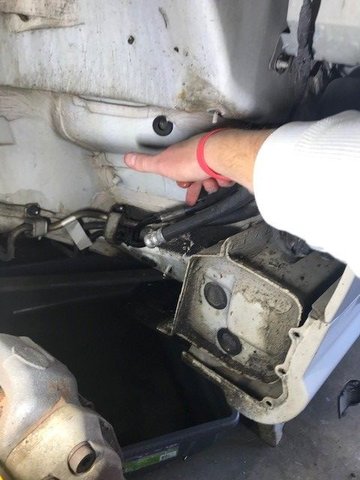

Got some fluid in it and started the car. After about 10 secs I found the leak. It is the Pulsation Damper to Tee line. Small puncture where my finger is underneath the line. Thankfully its probably the one line that can be replaced at home and without splicing and adding a pressurized fitting. Now to clean up all the other hoses and components and hope the residual fluid is just splash from this line rupture. If not I believe a valve block rebuild will be next. Also hope after the install I can pressurize system and work out any air in the system on my own.

Something I forgot to add. My car tended to sag on the drivers side front after sitting for a day or two. Could there have been a small leak in this line that would have caused this problem before it ruptured or should I check for other causes before finishing this job? Thanks Again,

That is probably the best case scenario. That line wouldn't cause sag after the car is shut off, it does not stay pressurized. Your sag is almost certainly a bad o-ring on the left blocking valve in your front valve block. Probably a good time to rebuild it since the system is open and you have the wheel and liner off.
