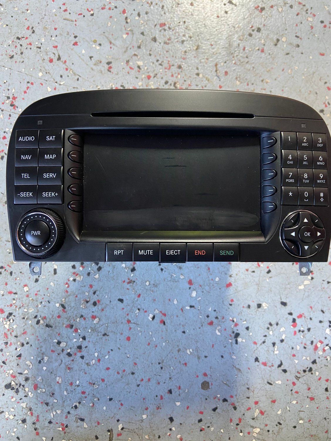

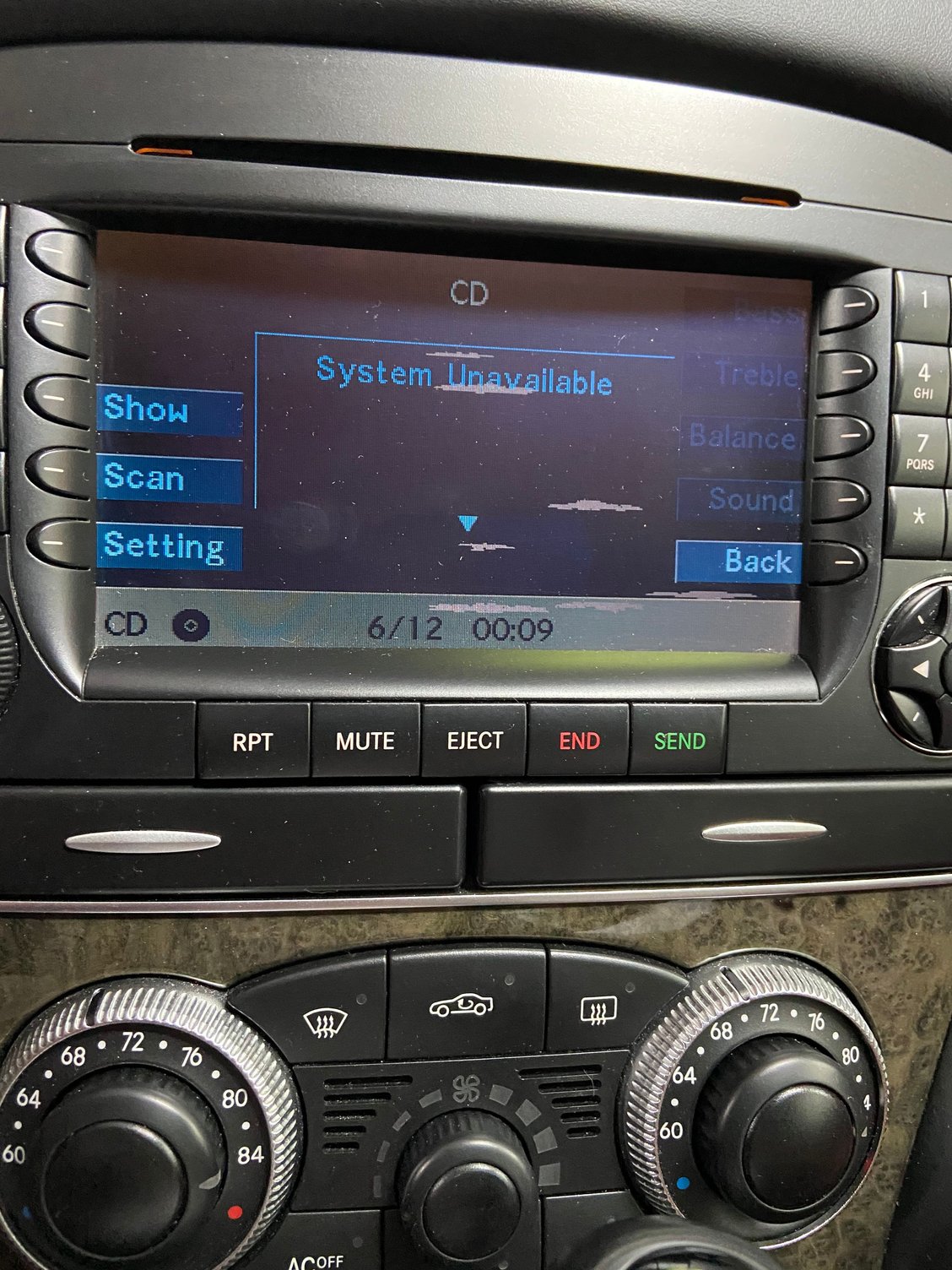

"BenzNinja". I reached out to him several months ago to put together his DAS system which has worked flawlessly!! In addition to this Peter is always available to answer questions. Actually it was his recommendation on the stereo system purchase. During my dismantling and removal of all the obsolete equipment from my car for the install of my new system, I came across the main problem for the audio not working? A broken fiber optic line. (see photo). After the removal process of all the equipment, (see photo) on to the new install. Again the "BenzNija" Peter was available to help with the wiring connections and install recommendations. After a lot of fiddling, rerouting, fabricating and long hours, its looks and sounds amazing. I still use my existing Bose Amp and speakers with the original fiber optics, after the removal on the broken fiber optic line. I had to reset everything in DAS with Peters help but it works great. I know have: Stereo music, AM/FM radio , Bluetooth, Phone, color graphic Navigation. DVD capabilities, App capabilities, a Large functional touch screen.

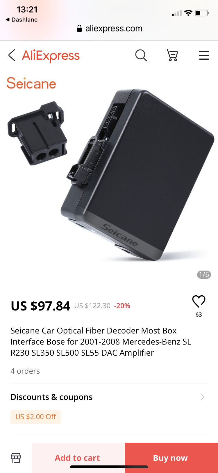

i see there are several options on this page below such as "6G 128G AMP Fiber" vs "6GB 128GB ROM" ...so what does AMP fiber mean i wonder? does it mean it works without the adapter you linked ?
https://www.aliexpress.com/item/1005...archweb201603_
