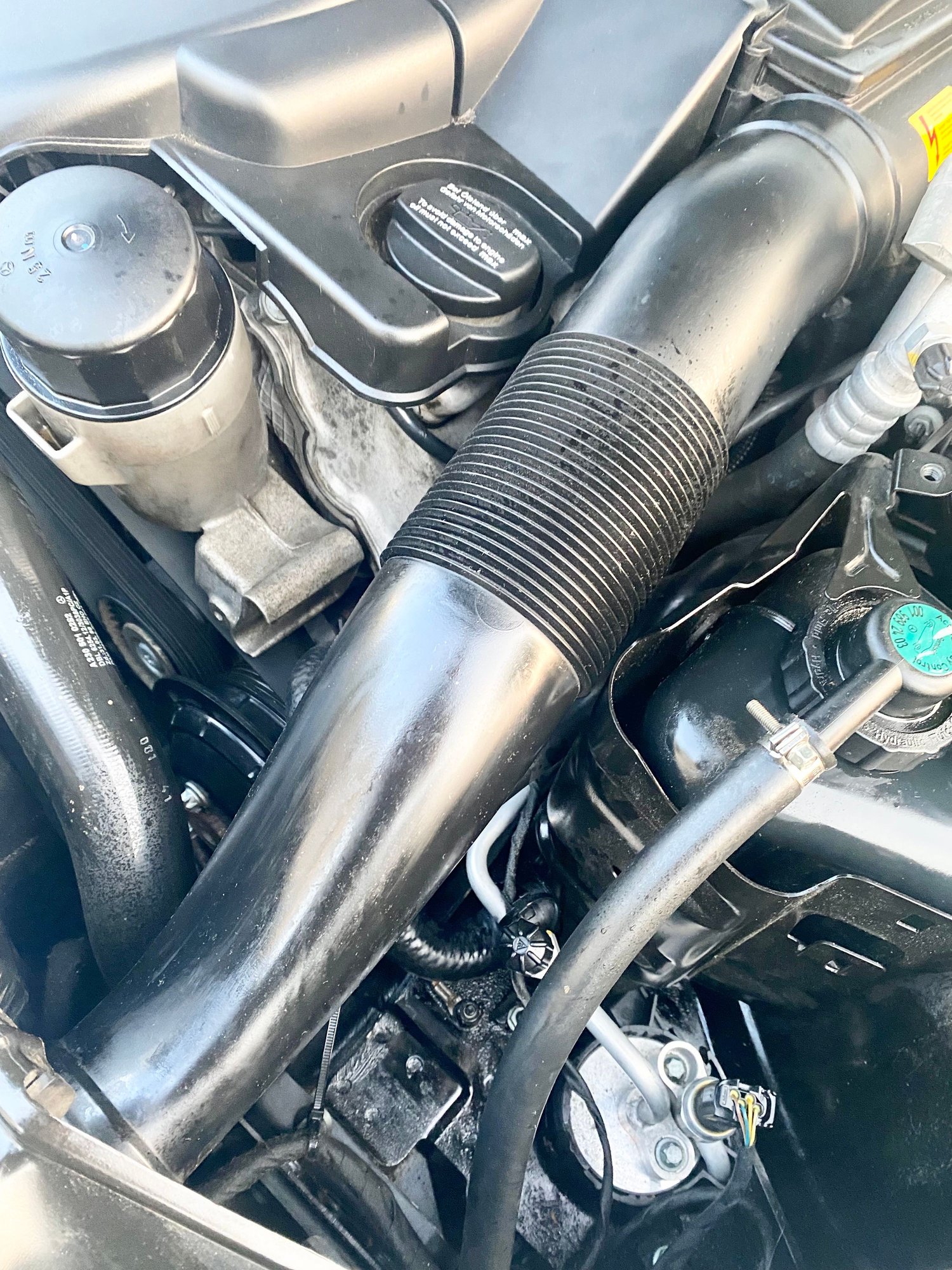

Started warm car, immediately got ABC light. Checked fluid, all fine. But at some point it spewed fluid all around the ABC reservoir. I cleaned and ran the car and no apparent leaks. It looked like the fluid may have come from the top reservoir. Is there any kind of pressure valve that could have gotten hung up that would have made the fluid come out of the reservoir? Pic is below. It sprayed to the rad hose and intake tube.

Probably a bad accumulator. Here’s a valuable resource for troubleshooting the ABC suspension.
https://mercedes-abc-drive-carefully...y-part-of.html
