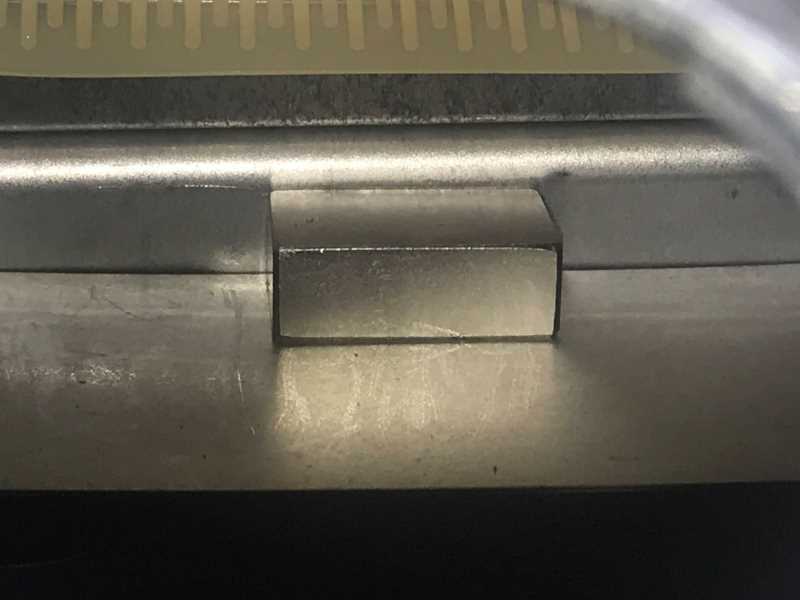

Yes, it's probably your gas tank baffle. Happened to me a few months ago. I used 2 super super strong rare earth metal magnets to fix it.
The magnets I used were larger than this guys and I only used 2. It's held up pretty good.
It's in German and the audio is terrible, but you can see how he does it.
Here's mine,
