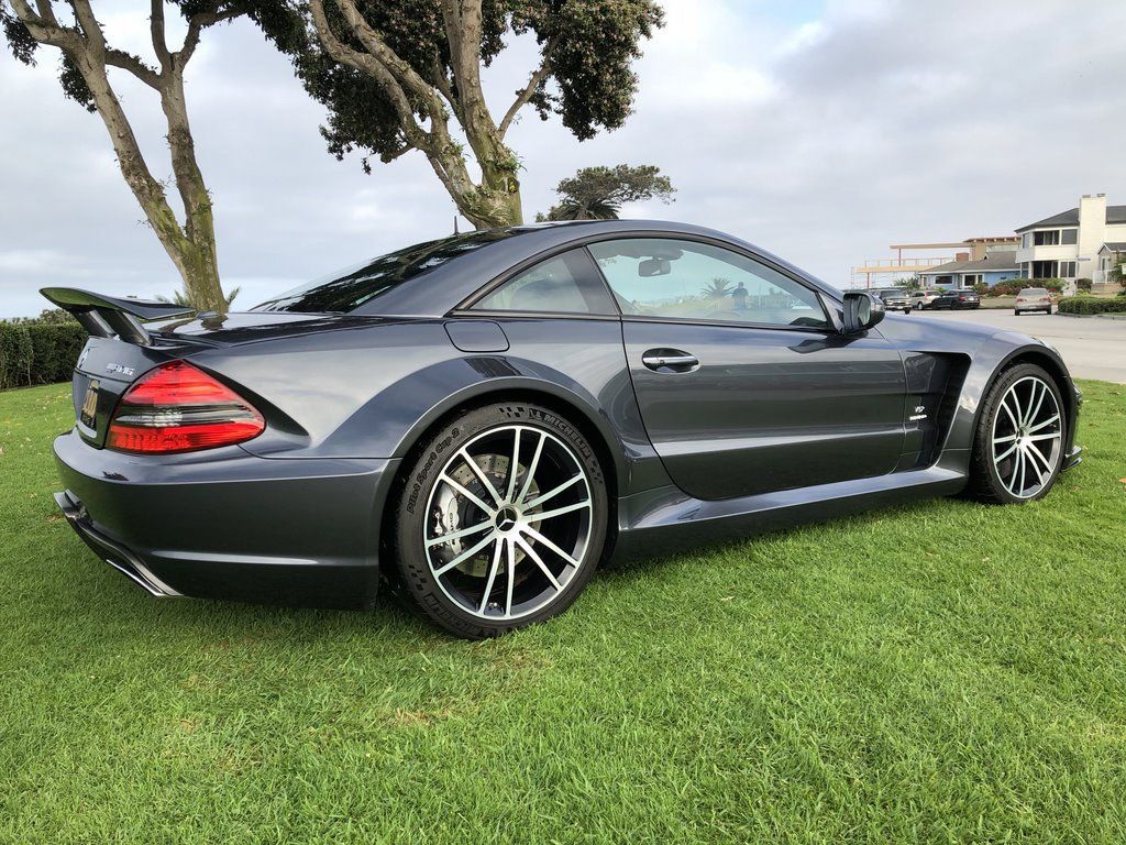

Yeah, I saw where some fools at some hack shop did coilovers on an R230. Totally ruined the integrity of the car. A travesty, I tell you.
I think the shop was called "AMG" or something, and they called their abomination the "SL65 Black Series". Probably "black" because they were so ashamed of their utter failure.
Hideous, isn't it?

And totally ruined like the sl350. I wonder how anyone could drive these abominations? That one there looks like it could veer off the road at any second.

Good looking rig, Bruce!

That is not my car - I'm poor, couldn't swing $300K+, so I'm having to make do with an SL600

That could just as easily make you poor. 😄
