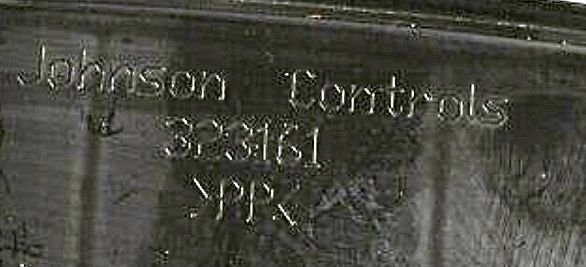

Hi have traced my PSE nightmares to a failed Passenger side, left side bolster lumber support reservoir, (black chunkcy toblerone thing with Johnson Controls 323160 stamped on it.
Its its a few pieces! Assume a large person had dramas getting out one day, anyhoo try as i might cant find the part number, all i can find is with a iflatable pad attached to it, this is just the back box thingy, can only find the ones for the multi contoiur seat that come with side bolster air bags, the 350 only has the lower lumbar support bladder from what i can see....

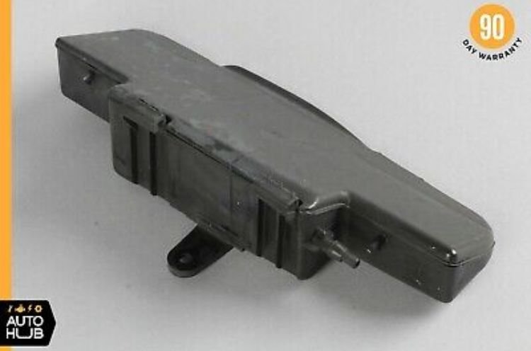

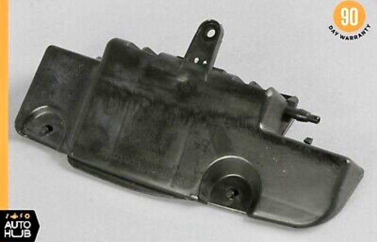

Lumber Reservoir part number mystery?
this is the black box i am looking for the part number of, int his picture its part of a SL600 so the straps on the right are for an flatable bag thats sits on it, my car does not have the bags, just this box, but its broken in sveral places, need a new one!

Frankly I didn't have a clue what you are talking about. But I think I am your hero.
A2308000-119 (left) or -219 (right).
The imprinted number on the photo seems to be one digit off.
