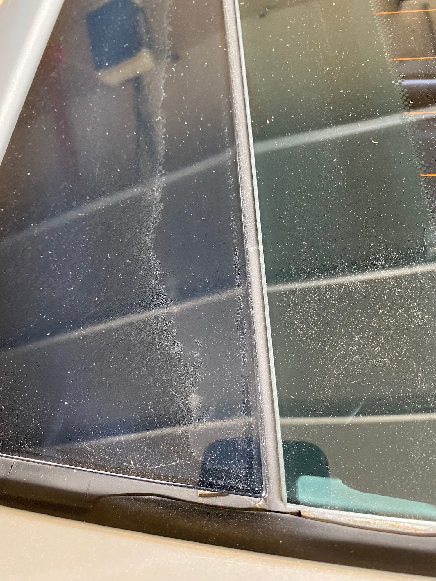

Hi, all, it’s time to get my 230 Roadster ready for Spring season. Has anyone replaced the left & right black plastic trim covers beside rear window? My covers are heavily weathered and very noticeable after washing car. Do I need to replace or has someone found a cleaver way to refinish. Would appreciate assistance.

I did a vinyl wrap on mine. Came out OK - definitely better than before, but not as good as new. If you decide to wrap yours, be sure to first sand them completely smooth. Mine had the gloss black finish flaking off. Even though I got any loose flakes off with a minor sanding, I left some of the finish on the panels and so the edges where the finish remains can be seen in the vinyl wrap.
I went ahead and bought new ones, haven't installed them yet. They're pretty easy to install, just haven't got around to it yet. Paid about $90 each.

I had mine repainted by a body shop for $100. Did on and off myself with simple body tools.

I just painted mine in situ, mask up the edges and rub down with 240 grit. then spray with colour of car and seal with clear coat. You can then polish them. Look great and only takes 30 mins

Thanks for sharing, your car looks great. The paint idea is getting to be the number one solution given the clear breakdown of the clear coar finish.
My trim is plastic, did you have same type of trim?

mine looked just likes these. if you mask up the edge use an orbital sander or by hand to remove the remaining clear coat and provide a smooth keyed surface. then on a nice day spray with Obsidian Black, leave 10 mins do another coat, leave 15 mins do another and then add your clear coat. Polish out with compound to give a glossy look ! Easy !

my plan is to try and restore thru some detailing methods (cutting & polishing) if unsuccessful last resort paint.
