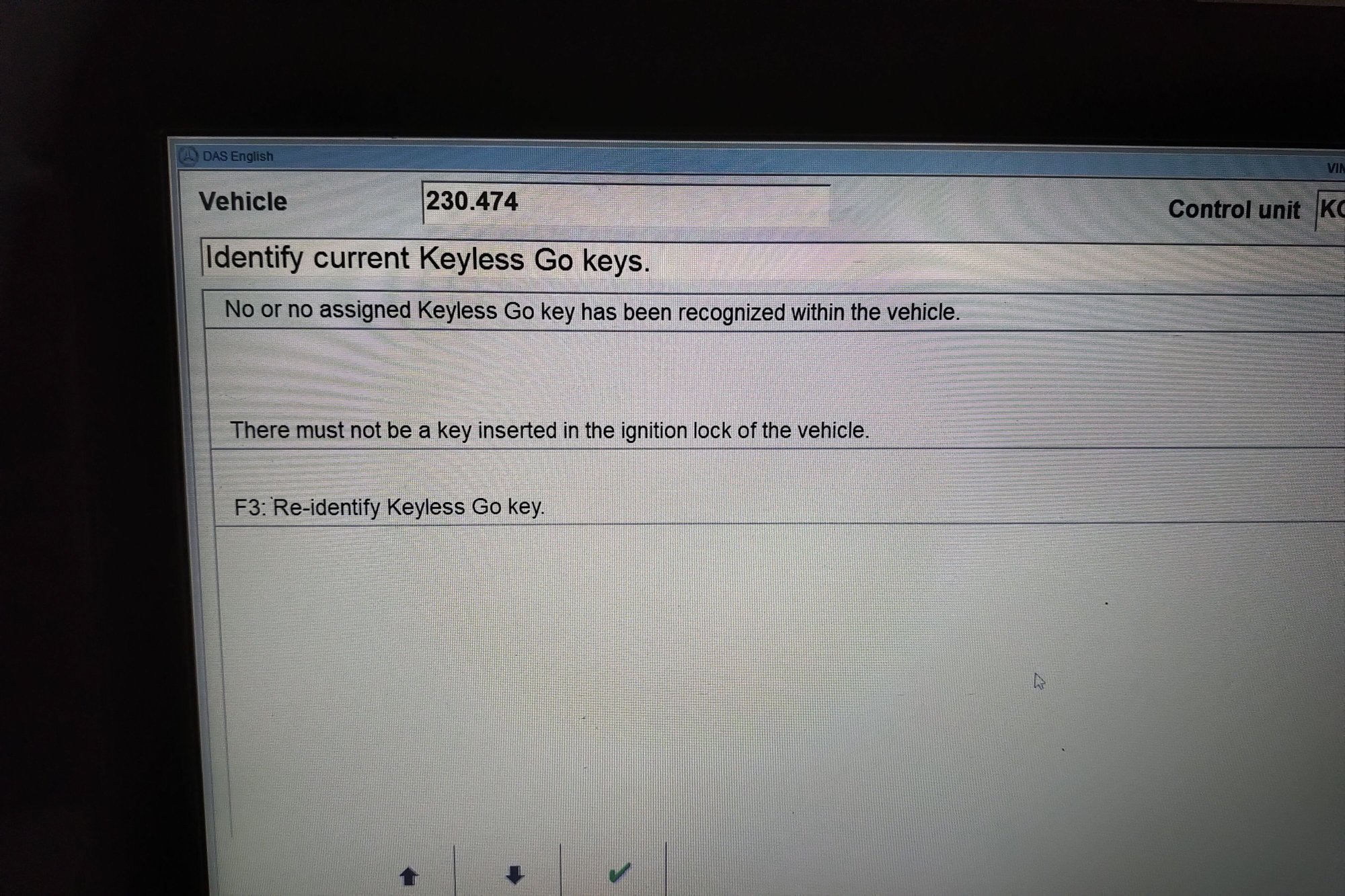

Did you identify the key track for the keyless go key and verify that it is set up as keyless go track 1 or 2?
this is what I'm seeing not sure if I'm looking in the right place
Old Mar 14, 2022 | 09:36 PM
MikeJ65's Avatar
Joined: Aug 2020
Posts: 1,329
Likes: 365
From: Gretna, NE
'03 SL55 Black, '03 SL500's Aegean, Mars Red, Tazanite, Alabaster, '11 S550 Flint Gray
Was that screenshot done with the black key in the ignition? Whichever key was inserted is Key 8, the one prior was Key 1.
Also, go to Keyless Go module -> Control unit adaptations -> Assign Keyless Go key to key track -> Assign Keyless Go Key 1 It will tell you the current assignment and allow you to change it. If the keyless go key is Key 8, it is not a Mercedes programmed key and might not be programmed correctly.
Old Mar 15, 2022 | 04:13 PM
Dennis Hartley's Avatar
Joined: Mar 2020
Posts: 15
2004 SL55 AMG
yes that was with the black key in the ign that one I got from Mercedes.
Old Mar 15, 2022 | 06:52 PM
MikeJ65's Avatar
Joined: Aug 2020
Posts: 1,329
Likes: 365
From: Gretna, NE
That's a little strange that the dealer would order a Key 8. You show keys 1, 2, 6, & 8 as used. Usually the dealer would order the next key, which would have been key 3. In any case, you can go to the Keyless Go module and assign Keyless Go Key 1 to key track 8. Also, confirm that the keyless go module is a 230 545 12 32, you can find it in DAS when you go to assign the key.
Old Mar 15, 2022 | 09:57 PM
Joined: Mar 2020
Posts: 15
2004 SL55 AMG
Thank you for all your help. Push button now works with key 3.
