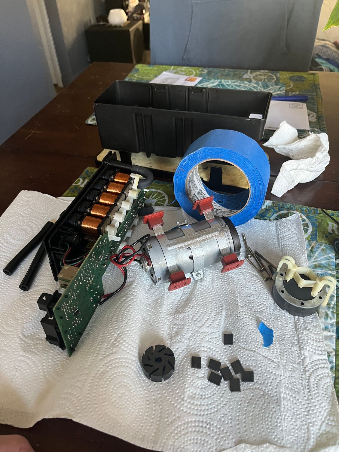

Old Nov 13, 2022 | 05:55 PM
Benznew2005's Avatar
Joined: Nov 2022
Posts: 20
2005 s430 matic
Rotor Vane question !
Have the pump apart . The rotor looks fine and the vanes do not look like the vanes in the Yttube I found which seems highly on point . My vanes have a rounded side and an angled side . So wondering whoever tried to re-build it had put them in backwards ? The screws were also loose so there is no way it was getting 3 bars .
Any opinions if the angled blade side vs. the round edge side ???? I have now seen a completely different pic with the vanes angled side out . Anyone re- build this chime in to clarify which side goes out ?
Thanks !

Old Nov 13, 2022 | 10:22 PM
Joined: Nov 2022
Posts: 20
2005 s430 matic
Saw the same vid
Yes that’s the exact same vid I watched. However he says “”put the round side of the vanes out “ . And I’ve seen several other vids to put the angled side out which makes more sense as it follows the contour of the rotor. Maybe this an older style vane ? because it has no angled side .
So i’m guessing whoever re-built it used an updated part , and like I mentioned, did not adjust the torque screws to the correct pressure .
I’ve got it all back together and will test tomorrow with a gauge and post .
