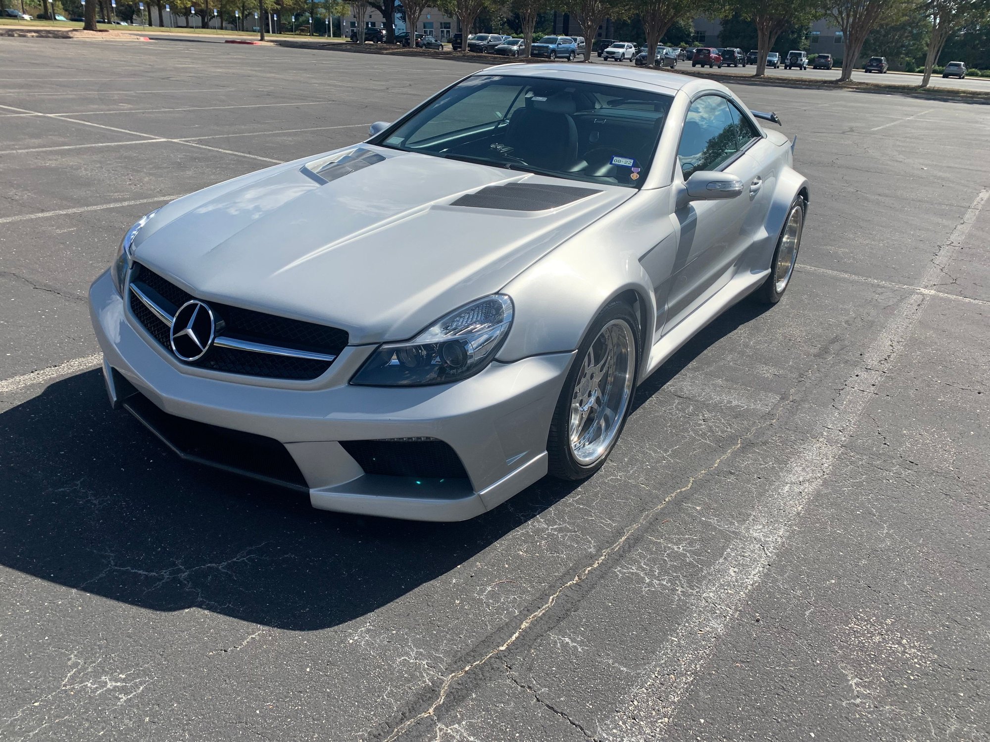

SL600 Misha Designs wide body. Flexfuel-E85, limited slip, coil overs, sway bars, 750rwhp, 850rwtq
Cool 2004 SL600 wide body
Replaced the ABC with coil-overs and front and rear sway bars from VVK. The front sway bar is very unusual for a V-12 and I had to machine special offset blocks..
All of the mechanical work was done by EuroCharged ATXl in Round Rock, TX. Including, the removal of the ABC and replacing with coil overs. They also did 3" down pipes, Complete fuel system including a a Flex Fuel Kit (can run on pump 93 to E85), Radium Surge Tank, very large fuel pump, bigger fuel lines and 550cc injectors. Of course, they had to re-map the chip. Blow off adapters on both turbos. Built transmission including modified valve body. Wavetrac limited slip differential. Dyno Tuned by EuroCharged ATX; 750 HP, 850 Torque at wheels. (Slightly de-tuned to protect the drive train).
the 275 rear Mickey's give it a little rake.
Misha Design's wide body came with a 2012 front face. Lots of carbon fiber inside and out. All body work by ProTek in Austin, TX
Interior has Black Series seats, black dash, full carbon fiber trim.
