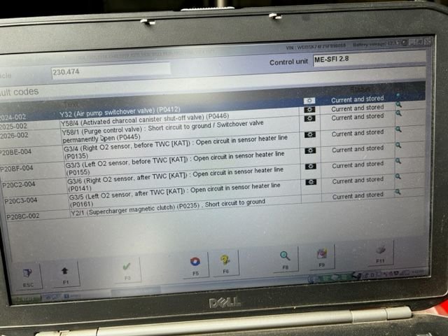

This is a follow up thread to the several discussions regarding an SL55 supercharger not engaging at the electromagnetic clutch. Thank you all for your sage advice--it helped immensely. While no one had the exact fix, you all got me going in the right direction leading to a simple solution. See the attached error codes.
I noticed a significant drop in power and suspected the SC. Sure enough, the clutch wasn't engaging. I read one thread here suggesting it might be a diode in the connector, but ruled that out after inspecting the connection. No diode was present. The relay "Q" tested fine as well, someone suggested that might be the issue. The fuse was fine. Several threads thought the electromagnet was dead. That seemed likely. Several threads here and Youtube suggested to do an unconventional repair by heating the SC shaft after removing the bearing and clutch housing that engages the SC belt. Some suggested heating the shaft and removing the magnet without removing the entire SC. I was just about to try the removal using the heat approach with the SC remaining on the engine.
