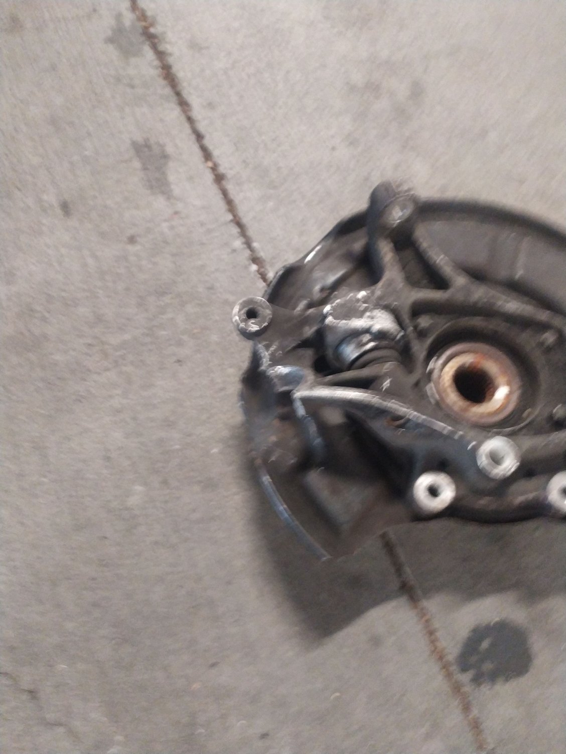

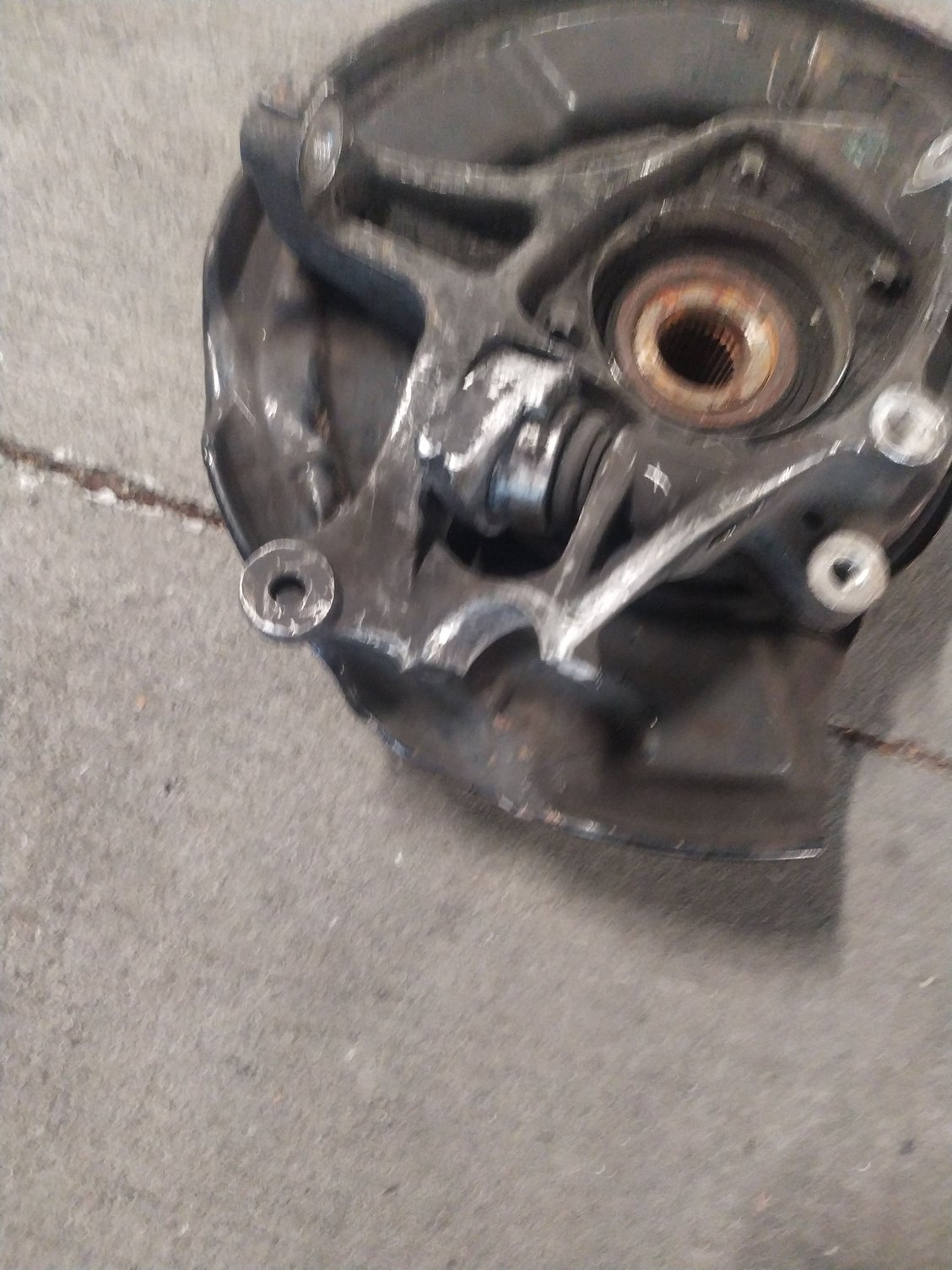

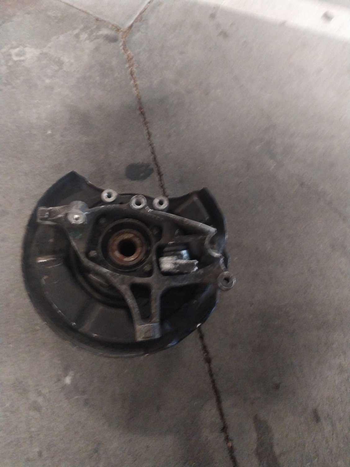

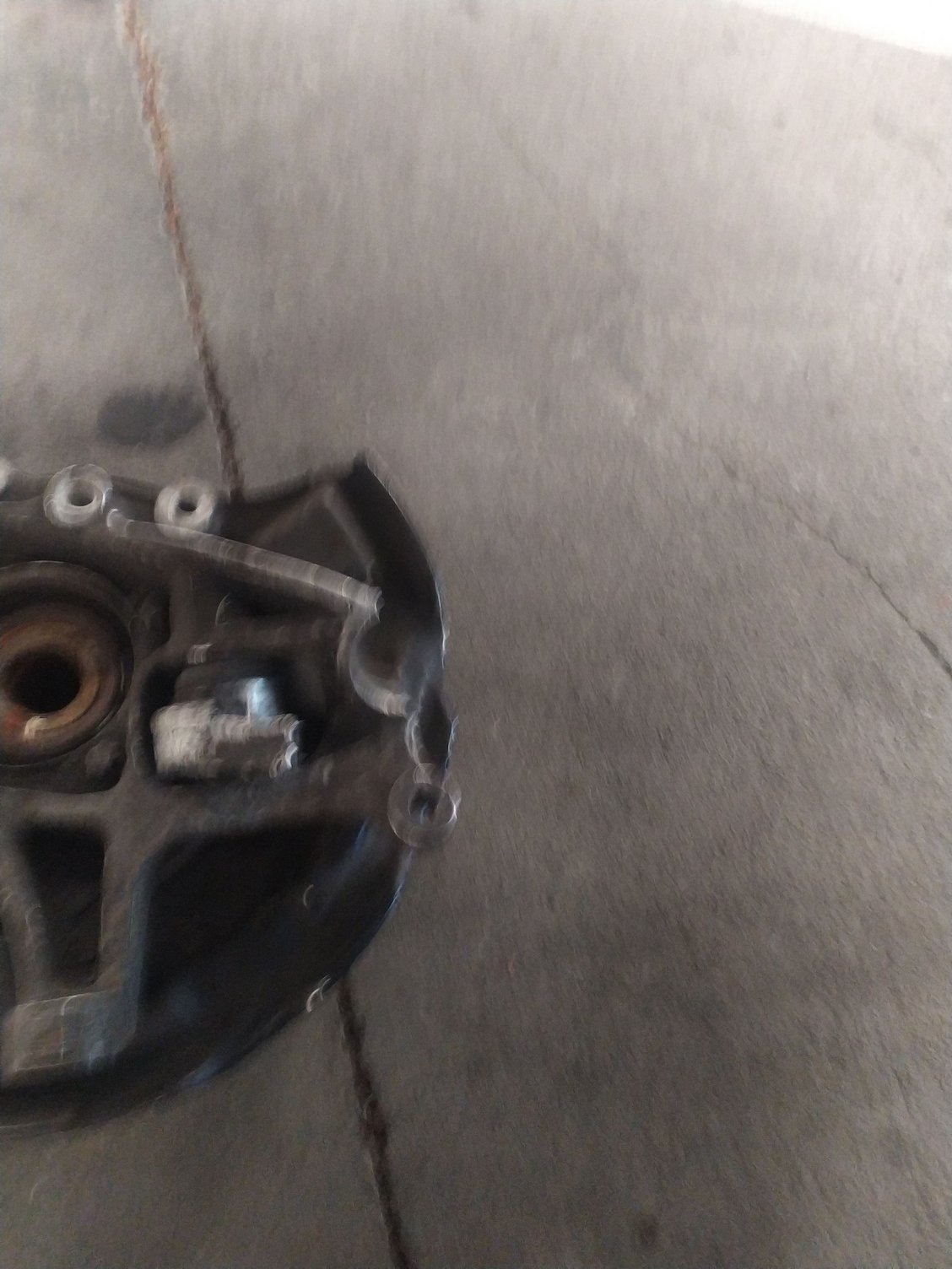

The torsion link which connects to the frame to the front lower portion of the hub fractured and when it let loose it snapped the lower control arm in half. They say a picture is worth a thousand words, so I'll attach pics of the failure point on the hub that fractured..

Thanks for the guide. A couple of things to add. That 'bushing' that you show remaining on the hub from the broken control arm is actually a cylindrical ball joint. They tend to wear and increase negative camber. These are heavy cars and love to eat ball joints front and rear. I made a press out of a bolt, nut, and washers to press that sliding bushing back flush. That is probably the biggest hang up on the job because you think that the control arm should go back in the slot you removed it from.
Yep. Trying to remove the lower control arm with pry tools whilst still on the vehicle is an insane proposition because no literature clues you into the fact that that cylindrical ball joint that you describe is secured by that protruding dowel. I'd have never figured it out on my own and feel so lucky that one Mercedes tech posted about it's existence. With that little bit of knowledge I knew it would be an effort in futility to try to hammer a new lower control arm back into place. Hopefully now others will now know why their efforts to install a new lower control arm into the hub seemed so impossible. Not even worth the effort to try. And considering that we are at the juncture where R230's are at an age where most folks will choose deleting ABC in favor of Coilovers, it's imperative that folks NOT attempt to disconnect the lower control arm at the hub but instead ONLY disconnect the lower control arm at the end nearest the differential. Either file down the dowel, or fashion a press as you did and save yourself a lot of needless heartache! But if lower control arm replacement isn't nxecesaary for your fix, then NEVER attempt disconnecting the control arm at the hub. Thanx for adding your solution. I don't wish that attempt on anyone!
