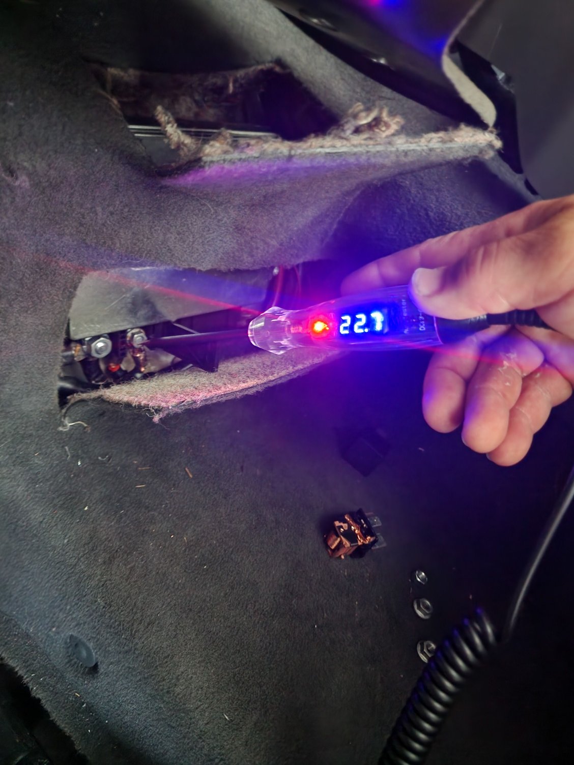

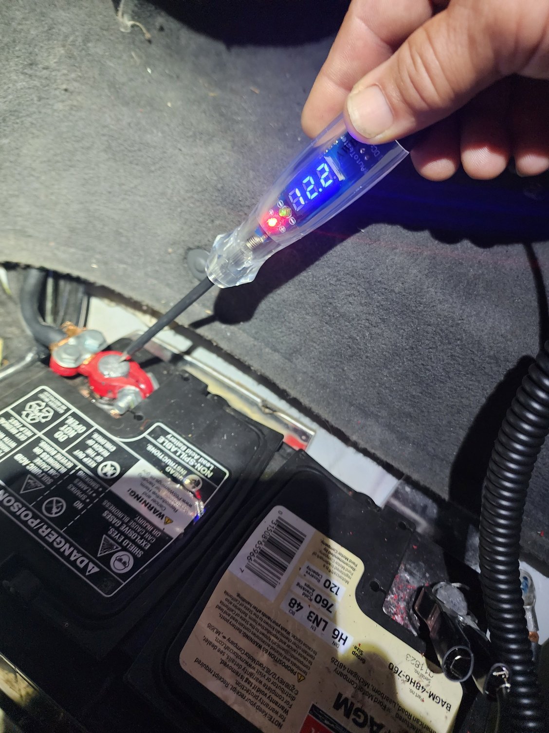

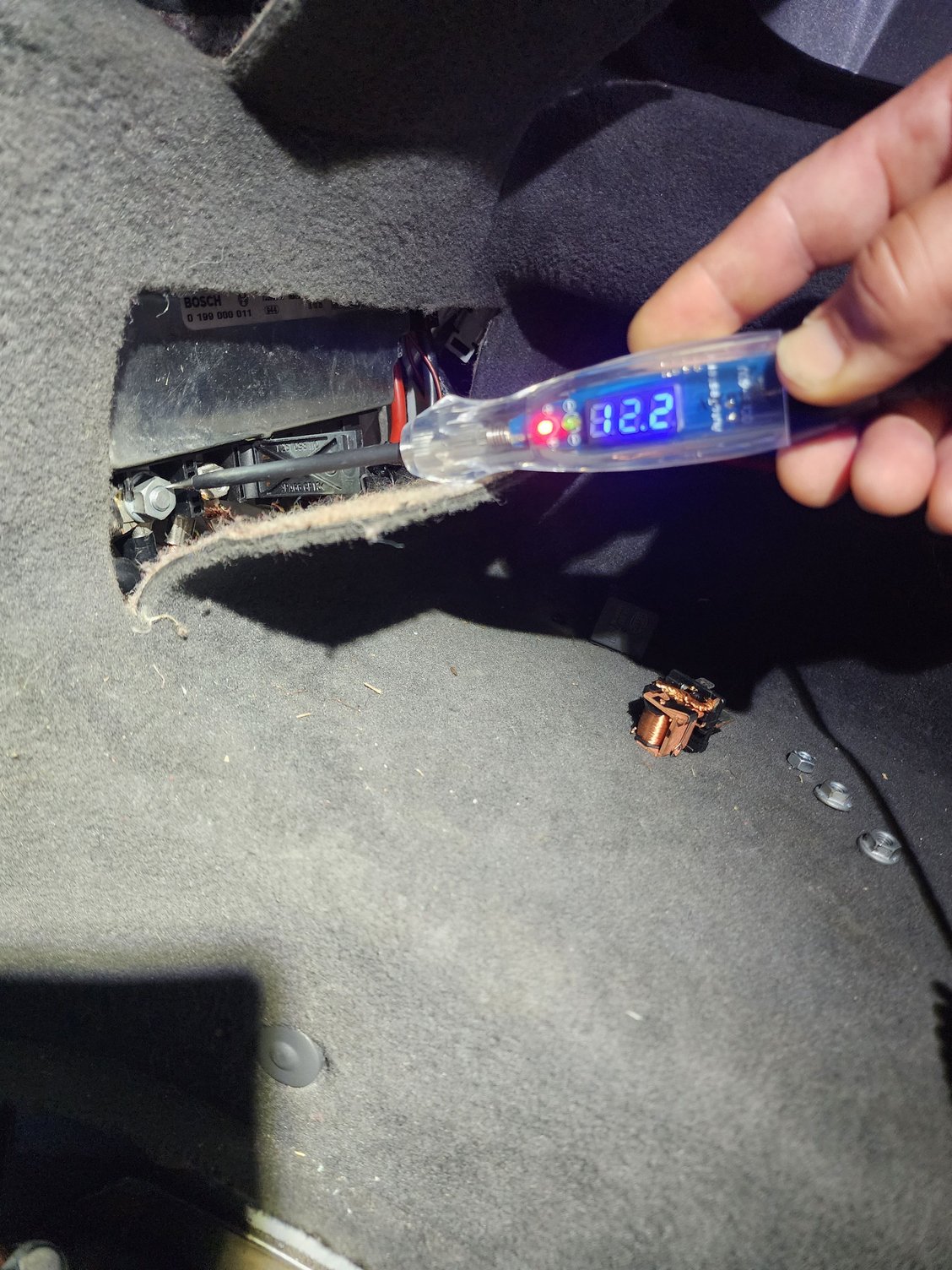

SL/R230: Can anyone explain this? I'm just guessing it's a short somewhere.
Battery ground to right post of bcm.
Battery ground to body of bcm.
Battery ground to lefr post of bcm.
Battery ground to positive terminal of battery.
The negative battery cable is disconnected during these checks.

The bottom two are rear battery voltage, top two have no reference and are meaningless. Install negative cable and retest. Also, positive battery cable should be replaced with a proper cable.
