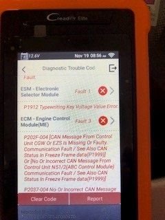

Gents: I am also getting the fault code P202F and as you can read below is related to the N51/2 which is the ABC control module....since I removed the ABC, I assume this module should be inactive. I wonder if after removing the ABC this module must be removed...! Any clues will be appreciated!

Jetta, I have been without ABC for a couple of years, removed the ABC fuse, bypassed the pump hose and remove valves and other ABC hardware, and keep on getting the white ABC warning in the dashboard....but lately I got a check engine light and trying to establish the source...... looking into the P202F code, I see is referring to the N51/2 which is the ABC control module...!
I wonder if disconnecting that module will get rid of post-ABC electronic warnings.!

BenzNinga can remove that issue with one 15 minute session Gene Did it for me.
