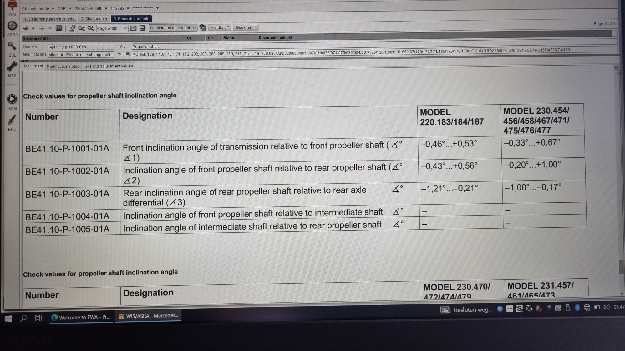

Originally Posted by Tom Manning
Going to do my flexies soon, what do you mean by setting the angles? (Lost my WIS in a computer change so haven't researched this yet). Thanks.
This is the one i use. Put it on the front shaft, reset zero, take it to rhe rear and reading shows angle. Same towards diff and gearbox. There you have to find flat spots horizontal or vertical to obtain correct angle readings.

I was able to measure the #2 angle today. It was off by 1.9 degree's. Measured -1.5 and it should be around +.4 (midrange) according to the above chart. I had to add 5 washers (around 10mm) on each side to get it to +.2. I sure hope this fixes my problem. I didn't do the #1 and #3 angles as I don't think I can easily get an accurate reading. I also noticed from my carrier bearing pictures that the spacer on the old bearing looks almost twice as thick as my new one. Anyway, I'm done for the day. I'll report back once I take a test drive.
