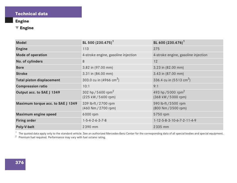

Why does everyone say that the HP on the R230 Sl600’s are 493?
Even a google search on that spec shows that result. But It’s incorrect…
Look at this old brochure from Mercedes themselves. You can clearly read that their Mercedes V12 bi-turbo produces 510 HP and not 493 HP.
“Sometimes you have to turn it up to 12. The SL 600 draws its strength from 12 bi-turbo cylinders. The V-12 summons 510 horsepower and 612 Ib-ft of torque.” -Mercedes Source

Power levels were bumped up a bit later in the production run.
The earlier cars, like yours, were rated for 493 hp / 590 lb-ft. "Everyone says that" because it is literally printed in the owner's manual.
In typical MB fashion, however, those numbers are likely on the conservative side.
