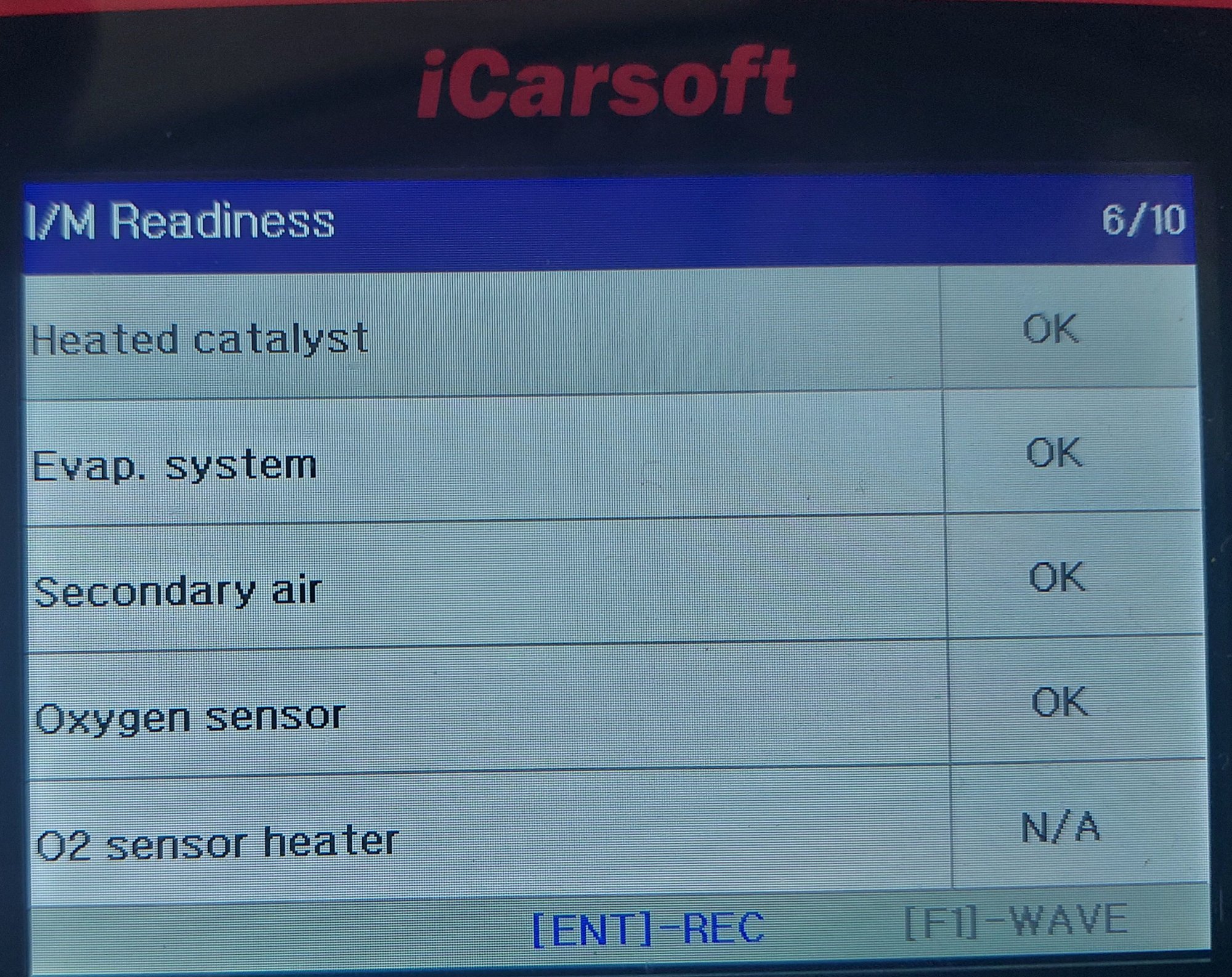

New MAF sensor is operational: at idle 8 g/s.
The Check Engine Light is ON. Car runs well under all loads.
Today, the left LTFT is -10.9% and the right LTFT is - 12.5%. So, leaking injectors might be an issue. I have never replace them (64K miles). My car has no fuel reg; the filter structure itself provides the suitable pressure on the basis of RPM. I bought a fuel rail pressure gauge to measure the fuel rail presssure at the sampling port.

PreCar STFT are at +/- 2% in both banks.
