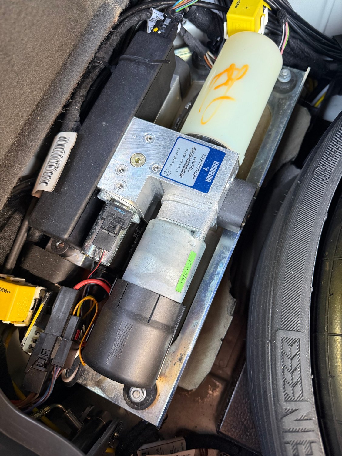

Hi I am new to the forum and have exactly the same issue as described here happen to me yesterday. Meaning I am in the situation the trunk is stuck 2”. Yesterday I wanted to open the roof and only the trunk went to its vertical opening state but the roof did not move. I then tried to close the trunk and it went down to 2” state and then everything stopped working. There is no more sound when I try to open the the trunk via the roof switch. Note that the safety bar button on the switch also did not work. I checked a few fuses behind the passenger side nothing bad. I am not mechanic but reasonably handy so willing to go down to do things. The trunk release worked so I have it now up and have access to the trunk.
Where do I check the fluid, sorry for my ignorance, and where do I buy it. Also I read here how to put it back in its state the trunk the 2” issue, please guide me on how to do that.
Appreciate your response as its time for me to get my hands in my baby that I want to keep forever.

UPDATE - using the Allen key I got the trunk back in position, and after starting I heard the trunk lock in place. Unfortunately I keep seeing the message that the roof is in operation going down and the roof switch and the rear trunk via my regular key continue not to work.
Here is a picture of the unit, does the fluid sit in the white portion, that looks really empty?
If so please guide me what I need to purchase and where to inject, I read @mrvedit to use a syringe.
Your pump is different than on my 2003. On mine you remove the screw with the female allen key hole on top of the pump to fill fluid. There are indicators with triangles pointing up and down around lines on the end of the white plastic reservoir cylinder to indicate fill level. Ebay has some hydraulic fluid injector needles and probably tubes/hoses for Mercedes convertible top.

On Amazon search for "Plastic Syringe". I've been using a 10mL syringe, but 20mL might work faster.
My 2004 pump is also different, but likely the brass colored screw covers the fill port.
Old Mar 26, 2026 | 12:35 AM
ameridap1's Avatar
Joined: Mar 2026
2007 sl55 amg
Thank you, read some more forum treads on this seems my pump has an opening on the top of the white part, going to buy the fluid and then this weekend on it. Will let you all know. So happy to have found this forum.
