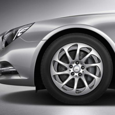

Attention 1309w....Please Note!
There actually is a 17-inch, genuine MB Wheel option for the 231, (10-Spoke in Titanium Silver), along with various, (run flat or non-run flat),17" tires to choose from. This smaller wheel diameter, along with appropriate 17" inch tires offers MAXIMUM PROTECTION FROM ROAD HAZARDS..
This option may also be of interest to other members as well who live and drive in areas that have lots of road hazards, (such as the 'potholes' that are apparently a huge problem in the Northeastern States). I consider myself very fortunate to live in South Florida where most all out roads are smooth and well-maintained!
You can view the 17" 10-Spoke Wheel and various tire options by clicking on the link to the site below.. (The site linked below also shows on-the-car pics of the 17" wheel option). Just click below to view!
http://www.alloywheelsdirect.net/mer...oke_wheel_3216

17" is an extreme option (assuming it even fits massive NA SL550s front brakes). Much more practical option (which I've used for the last 16 years on both R230 and R231 SLs) is to go +1 in tire diameter (26.8") on the same wheels - 245/40-19 & 275/35-19(or 285/35-19) or for even more "protection" 245/45-18 and 275/40-18(or 285/40-18). I had/have no issues running these diameters on SLs. The only "issue" is when one is on border line of being over by 1mph or 2mph regarding being pulled over for speeding: say speed limit is 70mph and "they allow" you 75 before pulling you over, well with 1" taller diameter even though speedo shows 75 you actual speed might be 78 or so, hence a ticket.

Originally Posted by threeMBs
17" is an extreme option (assuming it even fits massive NA SL550s front brakes). .
The 17-inch wheel I mentioned is made specifically for non-AMG 231's,, so there shouldn't be any kind of 'fitting issue' for any of the non-AMG SL Class 231 models.
The 17" wheels are clearly NOT for either of the AMG models however, (i.e. the SL63 or SL65).
NOTE: If you've incurred severe wheel and tire damage from 'road hazards' where you drive your 231, then you should consider this 17-inch 231 MB wheel. (Be sure to note the 'on the car pics' shown on the site linked below).
Should be no fitting issues for any 'non-AMG 231 Model', (i.e. SL400, SL450, or SL550).

Originally Posted by bob55
This is a 17-inch wheel that is made specifically for the non-AMG 231's, so there shouldn't be any kind of 'fitting issue' for current non-AMG SL Class models.
The 17" wheels are clearly not designed for AMG models, (i.e. the SL63 or SL65).
Should be no issues for any of the 'non-AMG Models', (i.e. SL400, SL450 or SL550).
I would not be so sure. Some/many Euro SL(and CLS) cars (and probably those destined to Far East and down under as well) are "equipped" with much less powerful V6 (SL/CLS 350, and even I4 in CLS250), so no doubt in my mind those cars use (much?) smaller brakes than SL/CLS 550, hence 17". I do not know of any aftermarket 17" wheel in the US, regardless of how low the offset is, to fit 14.2" front rotors and massive front calipers of SL/CLS 550.
It's easy enough to check, just give Tony at Alloy Wheels Direct your VIN and he will let you know if they will fit or not.
https://www.wheel-size.com/size/mercedes/sl-class/2013/. Clearly 17" not applicable to EU (and US) 550, only to EU 350/400 due to smaller front brakes. Enough said.
All US 400/450 (with wheels package for sure and I think even without) get identical sized front brakes as 550 and I do not see how any 17" can fit on front of my SL550.
There actually is a 17-inch, genuine MB Wheel option for the 231, (10-Spoke in Titanium Silver)....
Taste is subjective but that is an ugly wheel IMHO...
As previously mentioned, if you 'STILL' have some doubt about the genuine MB 17" wheel for the 231 fitting your particular car, then by all means call Tony at Alloy Wheels Direct! (He can verify the fit using your car's VIN
number).
The 'standard', (stock) MB wheel in the USA for the 2013 SL550 was the 18" Twin Spoke Wheel, but that doesn't mean the smaller 17" MB wheel designed for the 231 won't fit. Tony, (see above), is the best source for MB Wheel fitting information.
From outside the UK Call this number: +44 1865 959 0000
or you may email Tony at sales@alloywheelsdirect.com

Note there are also some 'on the car pics' you can click on which are shown just beneath the large 15-Spoke wheel pic once you click to load the web page below.
http://www.alloywheelsdirect.net/mer...oke_wheel_3218
number).
