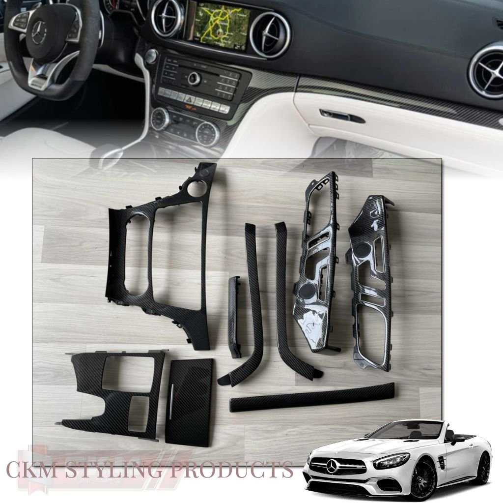

And I have that carbon kit for sale if anyone is intrested.

And those door piececs is a one of experiment never released ot made before that I include for free.
