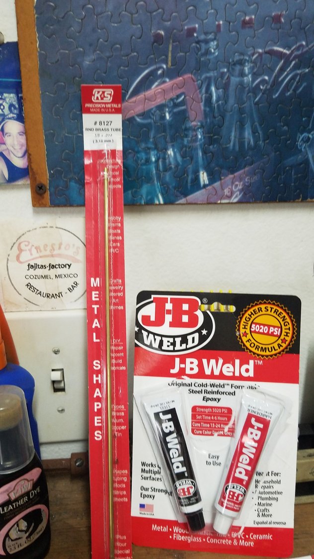

Hey Docscout. My quick fix didnt last. The inner spring receptacle broke as yours did so there was nothing holding the spring to provide tension. I re-examined the issue and came up with a fix. The tunnel that held the spring broke. I found a brass tube 1/8 diameter and glued it down with JB Weld where the tunnel was located. You have to take off the console door to do this which is easy by pulling out the hinge pin with a thermostat. aka old roach clip from the 70s 🤣. Glue in the tube, let it sit for 24 hours and put it back together. $5 bucks spent is way better than a $1200 replacement from the dealer

This was the tube that I used. It will have to be cut down to size which is pretty small, but it did hold the end of spring.

Hey Docsout,
Well my "fix" failed again. The epoxy didn't hold the brass tube and it pulled away from the door so the console door is no longer operational. I decided to throw in the towel and I found a replacement center console unit on e-bay. I'm just going to take off the broken door and replace it when it arrives. I'm not going to replace the entire console. It will be easier just to replace the one door. I suggest that you do the same. I found one for $175.00 but that is cheap as apposed to purchasing a brand new unit.
