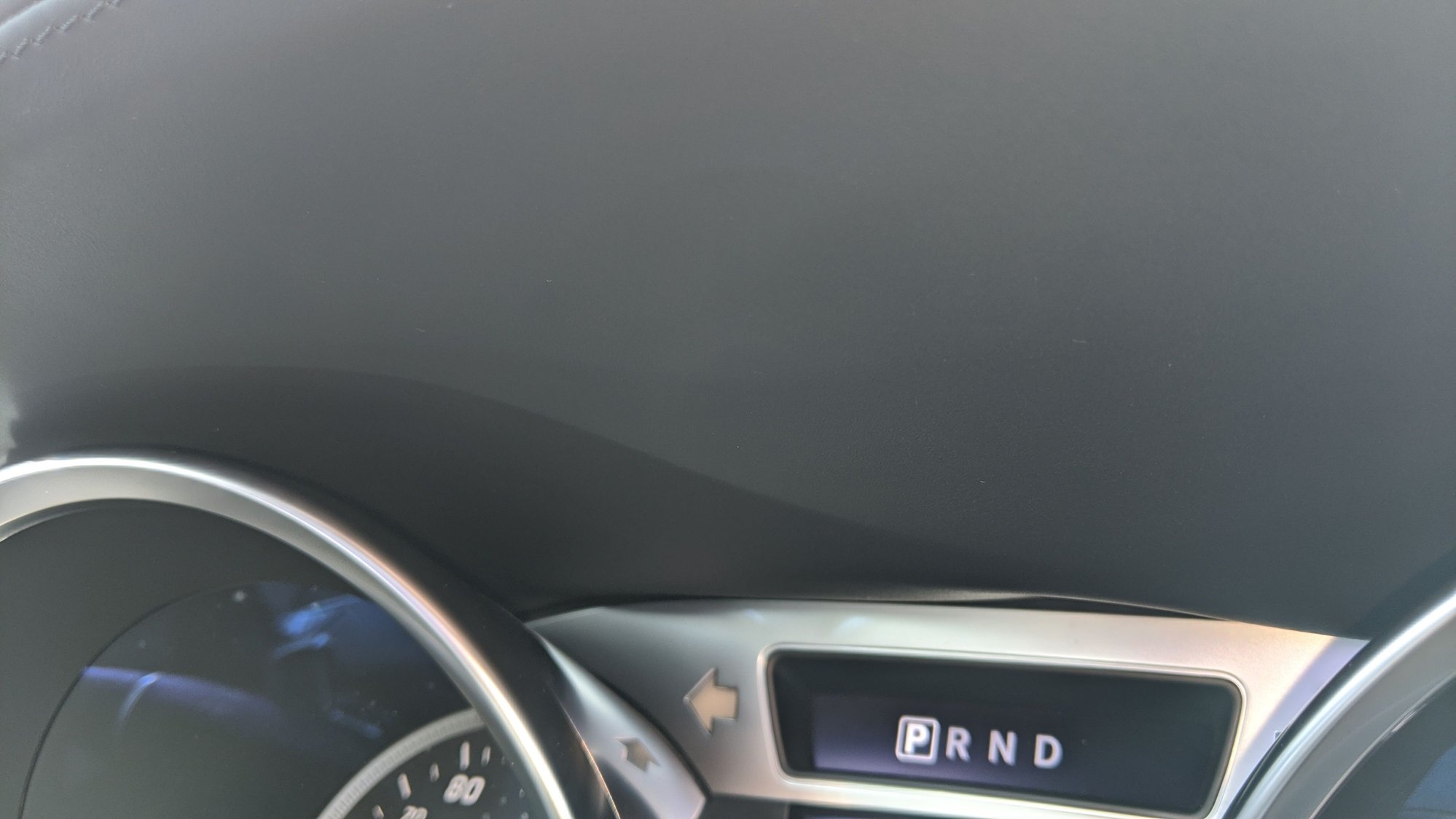

Thanks all -- great comments. Pics below. As I mentioned, the car just hasn't had a lot of sun exposure. I'm definitely not a "leave the top down" guy and it almost never in the sun for more than a few minutes.
Once I paid more attention while taking the pics, I noticed that the leather is actually pulled away from the back edge of the "shield" that covers the instrument cluster. You can see that pretty clearly in the second pic (side view). I also subsequently noticed that the underside is in the same condition -- pulled out entirely along the back edge and drooping down.
What I don't get is how it could happen in the space of just a week while in the garage the whole time. It's as if that piece of leather just said, "Okay, I'm done," and just failed all at once.
There is a small bump in the passenger side near the windshield that I actually saw show up a couple of months ago. But the console piece just happened, boom.
On the bright side, it looks like that instrument cluster shield or cover is actually a completely separate piece from the rest of the dash, so I'm optimistic that it might be able to be replaced without having to replace the entire dash. Anyone have any thoughts on that?
Top of "shield" or "cover" over instrument cluster.
Instrument cluster "cover" or "shield" from driver door.
Underside of instrument cluster shield. Leather is pulled away from back edge near PRND and drooping down toward top of speedo and tach.
Small bubble on passenger side just to the right of center speaker near windshield.
Slight puckering between speedometer and driver's side vent.

Without pictures we can all guess. For one, this is covered under warranty, so that's not a big deal. The issue is that the dash needs to be pulled and ideally this is to be avoided. No fun to have the interior taken apart. Lots of care is required to keep the car rattle-free...
That said, can leather dashboards get damaged in the sun? Sure. Same as plastic dashboards can crack in the sun. When cars sit without airflow (running or driving) things can happen. Often poor manufacturing is exposed. Like too much stretching or stitching too close to the edge. Typically prevalent in English and Italian counter parts.

Yes, this appears to be a glue issue. Too extensive for any fix. This needs to be replaced...
Yeah that's what I was assuming. I just hope the dealer doesn't try to pull the "oh you left it in the sun too long, not our fault" crap.
Should I settle for having just the "hood" over the instrument cluster replaced since that's the bulk of the issue, or is it fair to assume that it's just a matter of time before the rest of the dash does the same thing? (Since there's already that bubble on the passenger side, too.)
On the one hand I'd like them to tear apart as little as possible, but on the other hand I want it done right -- and it looks like they probably have to remove the whole dash to get that "hood" panel out anyway?

The complete upper dash, but MB can determine that. This is unacceptable and will be covered by warranty.
