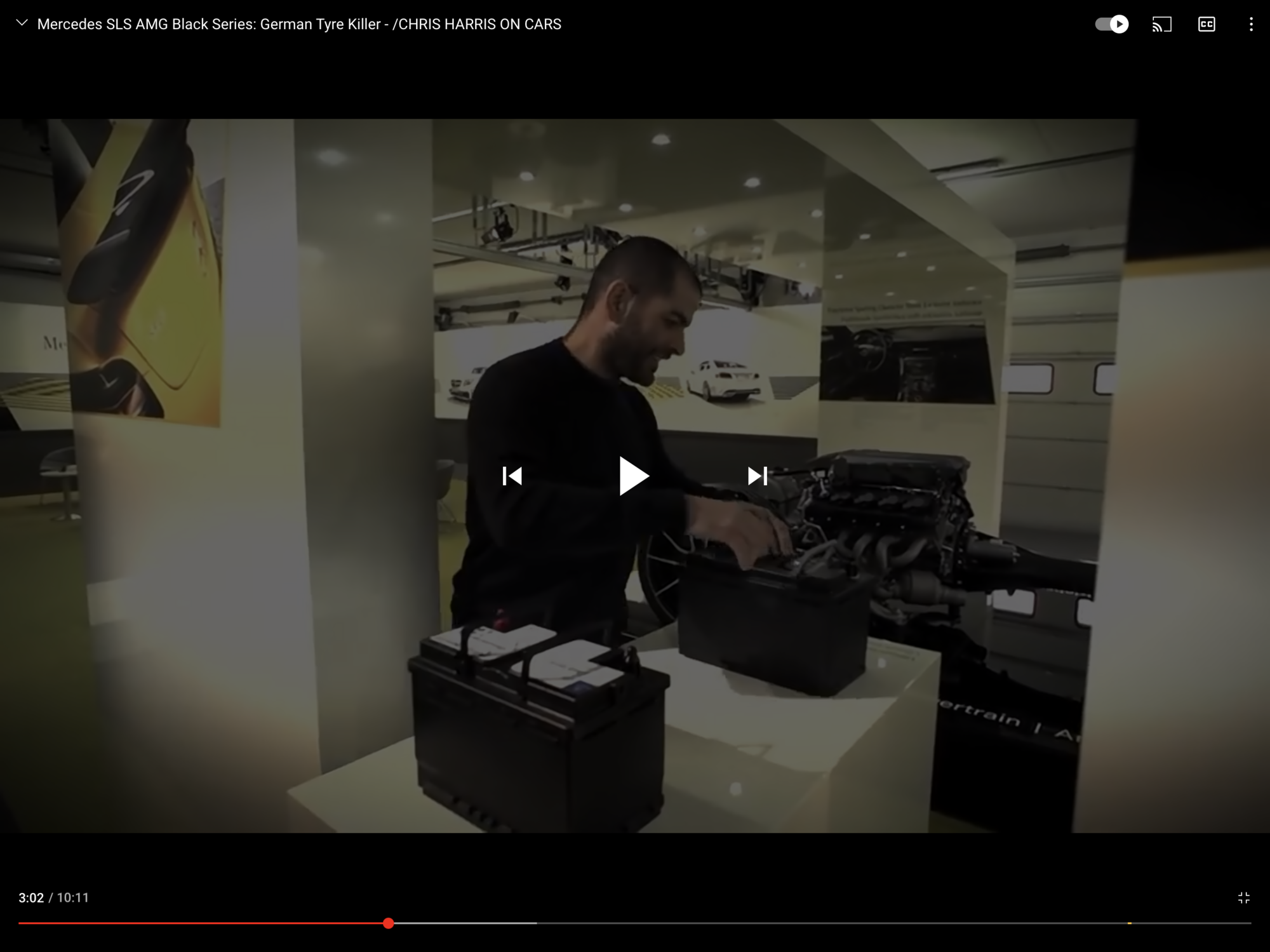

Mercedes 12v lithium battery
This is the 12v lithium battery using similar technology which Mercedes put in the SLS black series which runs with the standard alternator.
See YouTube Chris Harris on SLS Black Series.
Yep. As I mentioned, I had a 12v lithium battery in my GTS -- probably the same one as in the SLS and probably the same alternator. The owner's manual was very clear about using a charger specifically designed for a lithium battery. I just think that you should be very careful and make sure you've researched whatever you choose to do. Let us know. (I could not get the video to play.)
Old Jan 3, 2021 | 07:36 PM

It’s not a video - just a screen capture. You can find the video on YouTube.
point is that it just uses the standard charging system found in any other Mercedes rather than a specific lithium charger.
If you use an external charger, it does need a different one from the normal chargers as they are quite different from the car charging system.
Old Jan 3, 2021 | 07:59 PM
Dr. Manhattan's Avatar
Joined: Jul 2018
Posts: 563
Likes: 171
From: Nothern Georgia, U.S.A.
'17 SL450, '25 Lyriq, '25 Sonata Hybrid, '96 Corvette GS coupe
Nothing says that the SLS Black's lithium battery charging system charges with the same voltage curve as any other M-B. That car's alternator could have a special voltage regulator for the lithium load. Or, the battery could have it's own voltage regulator, but wouldn't that also require some accommodation on the part of the alternator? I know Porsche sells a lithium conversion battery for the 911 that costs around $1700, but that battery does have its own control electronics built in.
Old Jan 4, 2021 | 04:50 PM
Piperkid's Avatar
Joined: May 2017
Posts: 61
Likes: 11
From: Phoenix
2015 SL400, BMW Z3, Datsun 280Z, a couple of jeep Grand Cherokee's - And a Commander Airplane
The fact that Porche's battery has this circuitry which over the counter batteries do not - should confirm that you cant just remove an AGM battery and replace it with lithium.
