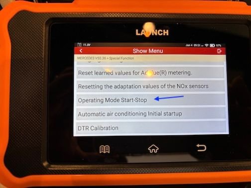

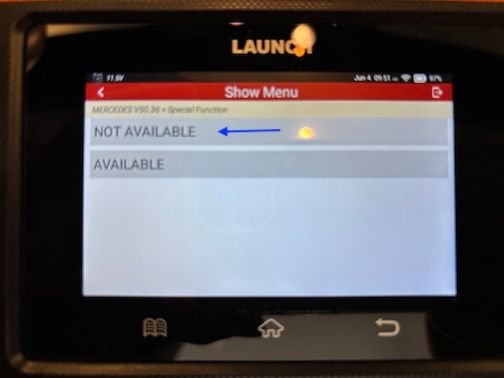

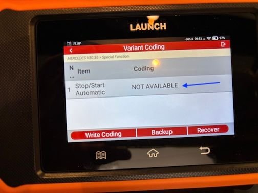

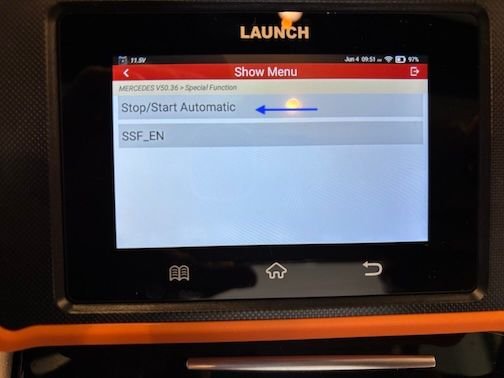

I just purchased the Launch Creader Elite v2.0 for $145 CDN. It allowed me to disable the Eco Start/Stop for my 2019 SL450.
The sequence to make the change was different than some of the other instructional posts I've read:
