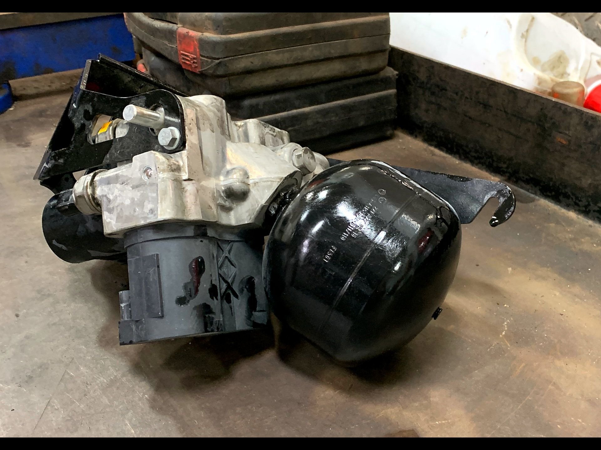

Follow up R231 2013 SL550 , ABC pump or damper or both
Hello again all, remember my post “Problem that no one can identify”
Well after reading different comments and agreeing that the problem sure sounds like the pulsation damper, I had it replaced by an independent Mercedes specialist shop that I trust.

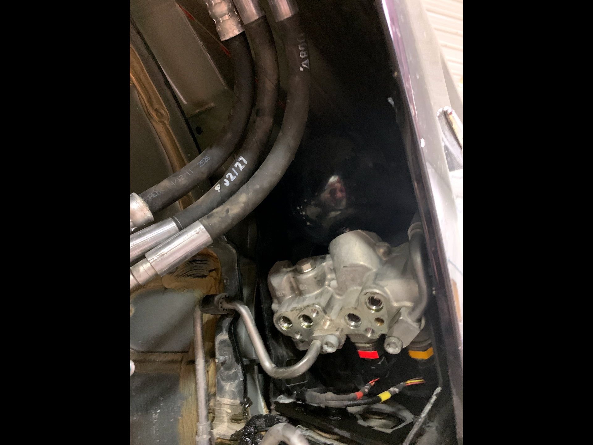

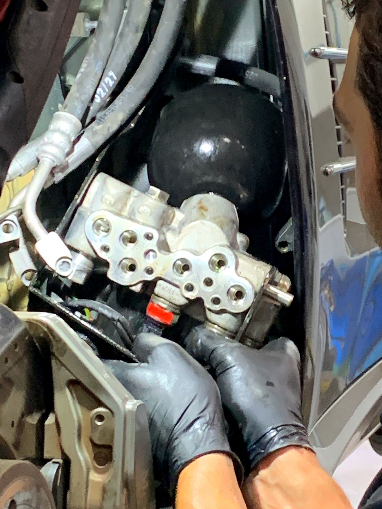

I am including some pictures with this post that can help Identify the problem. This is for a R231 2013 SL 550.
It’s difficult to pinpoint the sound because it starts at the output of the pump located front and center on the engine, travels down the pressure tubing inside the left front mudguard down to the valve block and finally to the Pulsation Damper.
It’s now my experience that the sound can start from either end making it hard to pinpoint is it the Damper or the pump. I was hopping for the Damper.
I don’t think that this is a DYI project unless you have specialized tools, look at the photos.
The first thing, my mechanic used was his High Teck diagnostic tablet to reduce the high hydraulic pressure down to zero without having to disconnect the hydraulic lines.
The first picture shows you the location of the Pulsation damper on a R231. Front left (Driver side) hidden behind the valve block and complicated to get to.
A special thanks to Mercedes for putting it in such a place that you must disconnect all high-pressure lines to get to it. The valve block and Damper are on rubber mounts, so it was easier to pull it out than loose time fiddling with it.
Once replaced, the mechanic used his tablet to increase the pressure back to normal, equalized the pressure on all for corners and told it to purge itself.
It was quite a sight to see the car jumping up and down on all 4 corners let to right, front to rear by itself for a few minutes to get the ABC system back to normal.
This whole operation took about 1 ½ hours. Here in Canada, the EOM damper costs $ 375 and 1½ hours of labor at $70/hour. Its close to a $500 repair. It took ½ hour just to get to the Damper.
