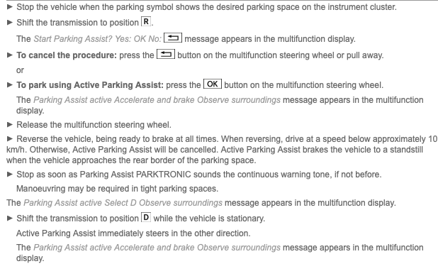

Originally Posted by JettaRed
I have the Active Park Assist (Code 235) and the little blue P when traveling below 18 mph, but cannot seem to get it to activate and self park. This also shows up as PARKTRONIC with Active Parking Assist and is part of the P01 Premium Package. Does anyone use this and can tell me what I should be doing?
Thanks
Detailed instructions in the owners manual - an extract below for your convenience - it will also drive itself out of the space.......

@rorywquin Thanks for the input. Still, I had to activate the features using my scan tool for those steps in the owners manual to work.
