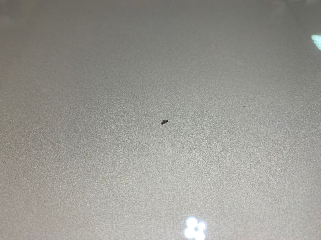

I’ve always found it difficult to justify the high cost of a quality PPF installation. Neither do I like the repainting idea.
I have taken the approach of trying to avoid rock chips with appropriate following distances, and for the few that I do get, using a quality touch up paint to minimize the appearance. After quite a lot of trial and error I have concluded that Dr. Colorchip is the best that there is. (No connection with them.). It’s key to have the right expectations: 1) no system is going to make the chip go away completely, and 2) it takes a lot of work (many coats) to get right.
Here are before and after pics of a hood chip (approx 1/4” x 1/8”) on the R129 SL500 that I acquired last year - the paint is Smoke Silver Metallic. From up close the chip is still there, but I guarantee that if you’re not looking for it you don’t see it, whereas before you did.
Reply 0

Quote: I’ve always found it difficult to justify the high cost of a quality PPF installation. Neither do I like the repainting idea.
I also used Dr ColourChip on my white SL. As stated in an earlier post, I can see them but only because I know they are there. Nobody else will notice them. Certainly a lot better than not filling them in.
Reply 2
