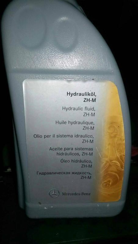

Your top will use Hydraulikol / ZH-M ( MB part number 000989910310 )
Febi Hydraulikol Febi Hydraulikol
I think the easiest way to fill the reservoir is to use a syringe with a tube attached to it. That’s what the official MB tool looks like.
There should be a fill plug on the side of the plastic reservoir. (see last picture)
It’s fairly self explanatory, but I’ll try to post the procedure from the WIS (for the R231) when I get back into my shop, and have access to my laptop with SDS.
The link above is for Hydraulikol from FEBI
Heres the Mercedes official version
MB Hydraulikol MB Hydraulikol
R231 Hydraulic reservoir fill plug:
