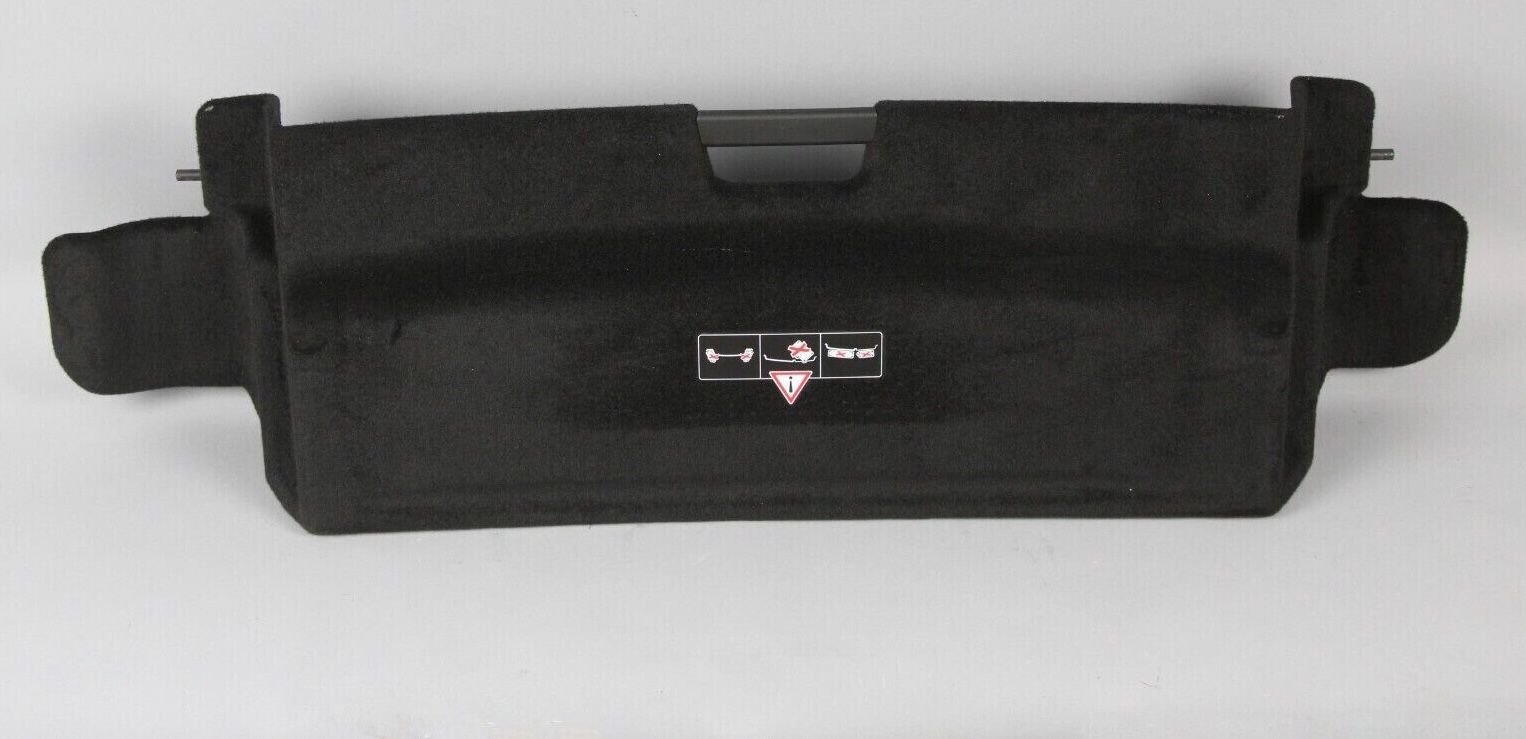

I have trouble getting the top protector to lock in the up position. Does anyone have a solution or is there an adjustment. Thanks in advance.
Are you asking about the part below?
Partition - 231-690-01-65-9F28
https://www.mboemparts.com/oem-parts...23169001659f28
Isn't this the pre-facelift one? I believe the OP has a 2017 where the partition is closing electrically.
Yes, which would make it even less likely to be the part @Hornet2CV is trying to describe. (but for identification purpose visually/location wise, they’re close enough)
Maybe “top protector” is the Vario Roof/Hardtop?
I’m sure OP will confirm
this is the top protector that must be in place to operate the vario roof. When this is pushed forward it should lock in place to allow placing items items in the trunk. There are 2 clips that accept a rod on this cover. They should hold the cover up out of the way. Mine does not hold so you have to hold it with your hand while loading the trunk. Question I have is sho7ld the clips be replaced. Thanks for the help
Are your clips broken? New problem or always been an issue? I believe there is also a limit switch on one side back there too (on the facelift 2017+ cars) that could be an issue sometimes.
clips should look like this PN A23196102149051
Clips look fine but could possibly be bent from use.
Clips will either be broken or not, in which case they should be OK. Rod could bend, but doesn’t your trunk partition raise itself electronically? (2017+) -Button on left side.
see 18:40 in video

I must say, feeling a bit stupid. The horizontal rod that hooks into the clips was not clipped in place so I have been doing it manually since I got the car couple of weeks ago. Clipped in and all works as designed! Many thanks! More to discover I am sure. cheers!
