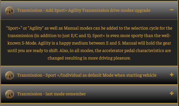

Without coding I don't think there is a way to default to sport mode when starting out. There are aftermarket products to accomplish this.

I have an oppurtunity to purchase a 2013 sl550 38k cdn. I had the car out for a spin yesterday for 4 hrs. when you put the engine transmission in sport mode (beast mode) this thing is very sporty. A few questions for those who own these. Can you save your preferences i like mine when it starts to have eco mode turned off and automatically be in sport mode. is there a way to save it as it defaults to eco and economy mode for the engine.
Get to know @BenzNinja as he has developed most mods you would want that can be done through coding. Here is a list. Look for the transmission mods.
https://benzninja.com/special-tunes/
