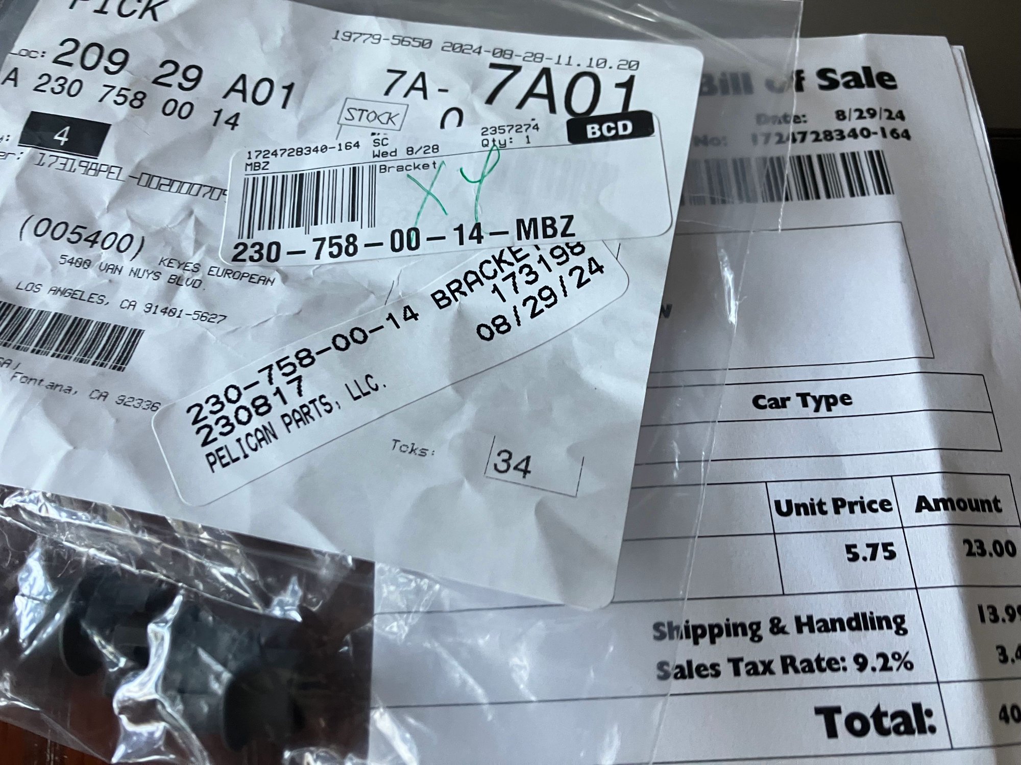

Hi! I saw that thread too, I ordered a handful of those bushings, hope that helps! I was at the dealer for a spare key (separate agony omg) and asked them to diagnose, they couldn't figure it out but suggest "the usual" which is begin replacing expensive parts on the "repair journey" dude is like "I like to call this step one" so if I can fix it for $20 at home I will be EXTREMELY PLEASED

OK, the gadgets are here - hoping I can figure out where this is going wrong and get the trunk recalibrated today

If the bushing doesn't work then I would look at the trunk lock mechanism before considering replacing a module. The lock mechanism has micro switches in it that tell the computer the state of the lock mechanism. Related to that is the wiring that carries those signals to the computer. One of those wires can break as a result of flexing when the trunk opens and closes.
I can attest that a problem with the lock mechanism results in a very wonky trunk lid. Symptoms were all over the place. Sometimes the trunk would not lower. Sometimes it would shut and latch and then immediately unlatch and partially open. You name it it did it. In my case it would do it only in cold weather and I determined that one of the micro-switches in the latch was sticking when it was cold. There's a thread somewhere on here of my whole experience.
In warm weather I think a latch micro-switch could still stick or fail, but first I'd check the wiring harness that runs along the trunk hinge. It's been well documented that wires in that harness can break from trunk lid movement.
