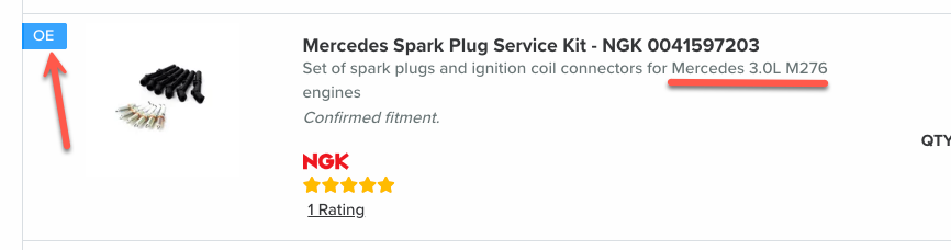

I think I'll go with these:
https://www.fcpeuro.com/products/mer...ngk-0041597203

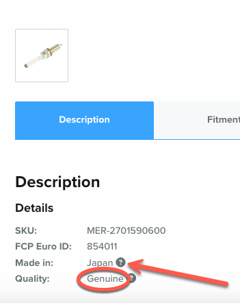

The Mercedes branded plugs are considerably more expensive. Are they German or Japanese?
FCP states that Genuine plugs are made in Japan. (See above)
Those are the plugs I used, though I got mine from RockAuto.
