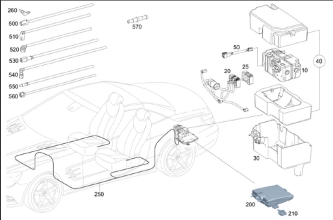

Here’s a thread that may help. I posted a bunch of WIS documents a while back, they may also help you:
Location of components and functions.
https://mbworld.org/forums/sl-class-...lfunction.html
Good Luck!

As always, check simple stuff first, fuses etc...
Here's the part you're looking at:
R231 Lumbar/Massage bladder.
