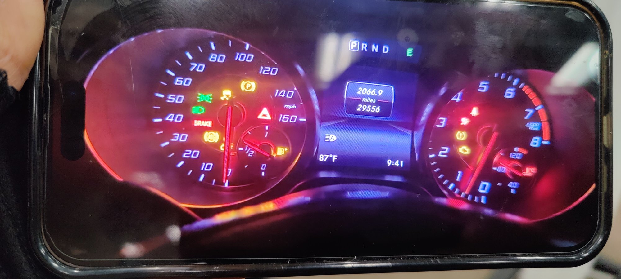

2016 SL550 dashboard lit up like xmas tree momentarily
Not my card but my friend's 2016 SL550 (29k miles). While driving at 30-40mph in city street. All the instruments all litting up like a xmas tree. Otherwsie the car seems to run okay but she then decided tp pull over the side to take a phone shot.
Then according to her all the lights just disappeared and have not acted up since. BTW, she got a new battery not long ago.
Has anyone seen this happened ?
Google AI seems to indicate a major failure in the vehicle electrical system.
See attached.

Usually a battery issue, try scanning the vehicle as well. Yes, I say a battery issue despite you saying you got a new battery, it is possible the new battery is bad (bad batch?). Check aux battery as well. If this vehicle has one.

I had this problem on my 2014 SL. In my case the lights didn't stay on. They turned on for a couple of seconds and then everything went back to normal after a couple seconds more. Basically, it's the instrument cluster rebooting.
I replaced the battery. The problem went away for a few months then came back. If that's what happened to your friends car then there's a problem with the charging system. In my case it was overcharging the battery and damaged it. I used a voltage logger while driving to see what was happening. A shop with Xentry may be able to bring up a charge profile history that can confirm this.

hello, Mercedes just kinda do this when the battery is low. The modules all reboot one at a time and youre good to go. Unless its something less benign than this, it's probably this. I'm pretty familiar with this drivetrain, less so on SL's since theyre rare/less popular but I think I have it with this guess.
Do me a favor pull the battery, get a Schumacher battery charger from Amazon, doesn't have to be anything fancy. Charge it all the way up.
It's possible she ran the battery down again and the batterys not full and the alternator doesn't charge it all the way or youre stuck in a feedback loop of constantly trying to top off a low battery after starting it.
