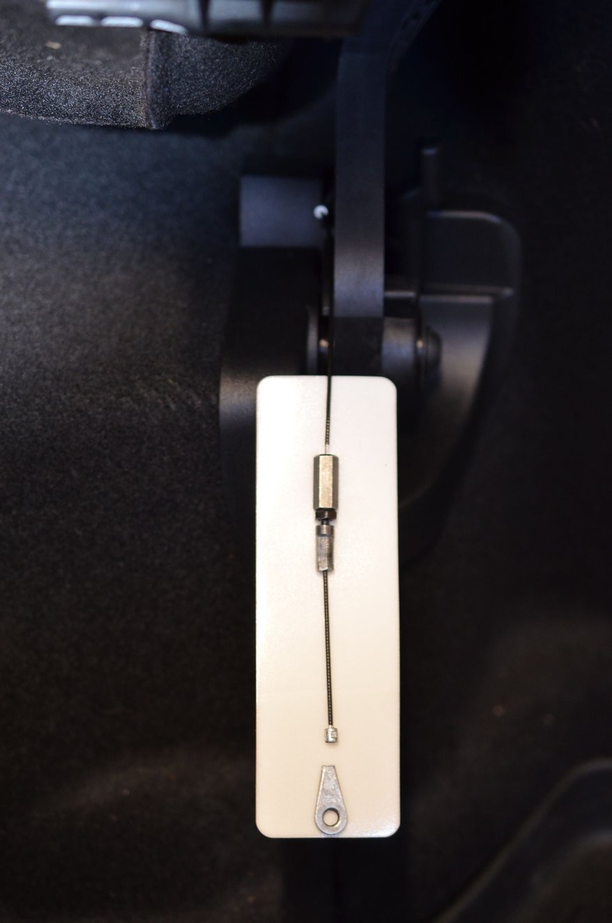

need part # for luggage cover

Got it fixed

Would you mind sharing how? It'll be useful info if it happens to anyone else.

Crimped on a electrical eye end.

Good fix... simple and elegant.
