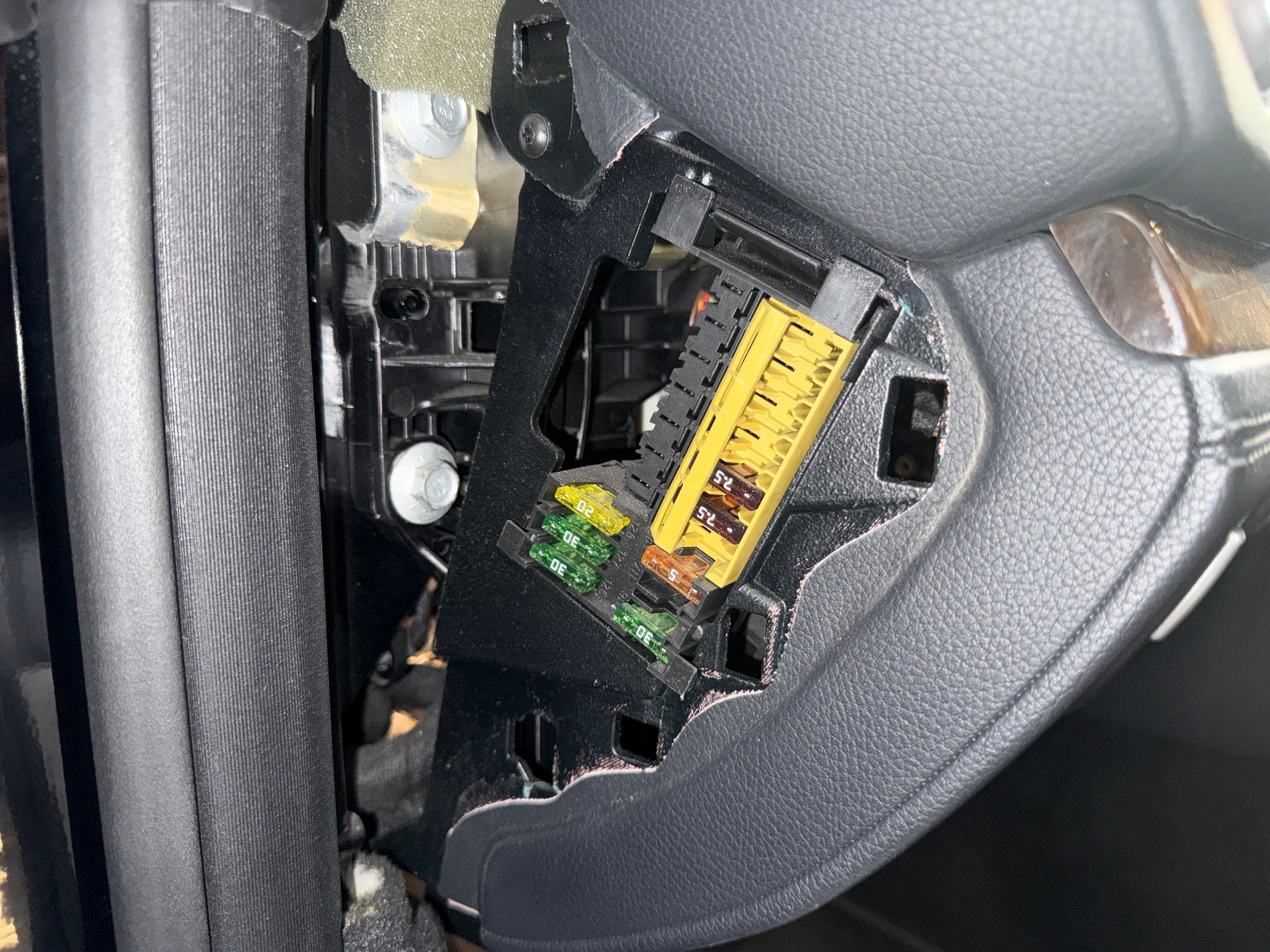

Hi everyone. I want to install a dash cam in my 2013 SL550. I want to hardwire it into a fuse. I don’t want to use the 12 V in the passenger foot well as the dash cam I am using is able to detect hits when parked. I am having a few issues.
1. I want to wire the dash cam into the fuse box on the driver side, not the fuse box behind the passenger seat. However, the fuses on the driver side looked to be integral fuses for the vehicle’s function (fuses for engine). I could also be wrong. I don’t really want to mess with that just for my dash cam. Which fuse do I tap into and in which fuse box?

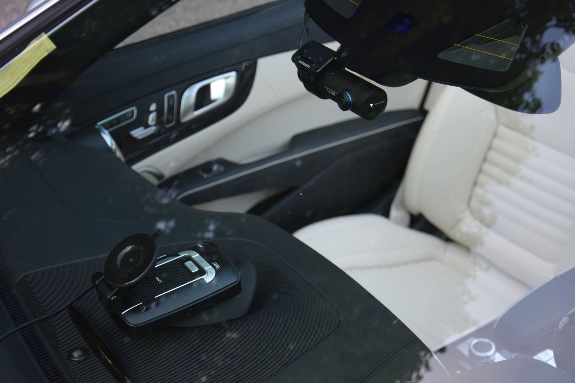

We had the radar detector and dashcam wired in and had to use both fuseboxes if memory serves. Passenger footwell for ACC (ignition) and the driver side for constant power. The pain was to run the cables from the right side A-pillar to the left side inside the dashboard through the center stack but it worked out easy once both of the bottom panels of the dash came off. The Dashcam needed both wires for the power management module.
Don't remember the fuses but the supplied chart above should help...
That was then and this is now...We wouldn't install a dashcam without a battery pack. Super easy as the battery pack can plug into the cigarette lighter or ACC fuse and the dashcaom only plugs into the battery pack and has no connection to the car.

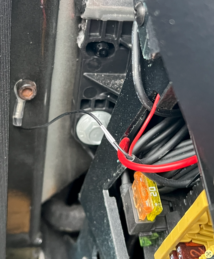

I have a permanently wired dash cam. Both the 12V and ACC wires go to the fuse block on the driver side. I tucked the wire under the head liner and A pillar cover — not hard. Once it warms up a bit, I will pull the fuse block cover and take a pic, maybe later today. I’ve had this dash cam installed for a couple of years with no problem. Of course, I drive this car almost daily.

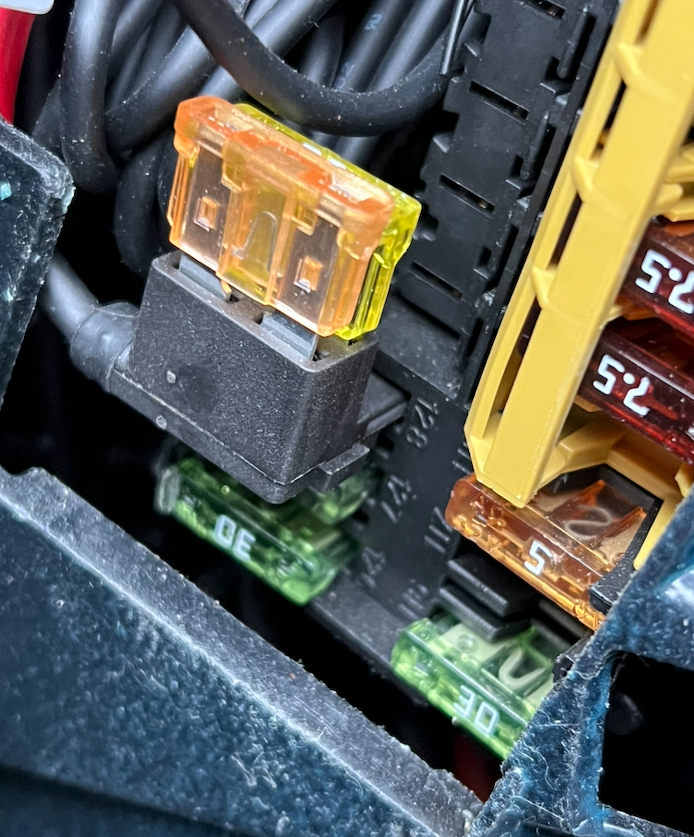

Here are some pics….
I used fuse slot 128.

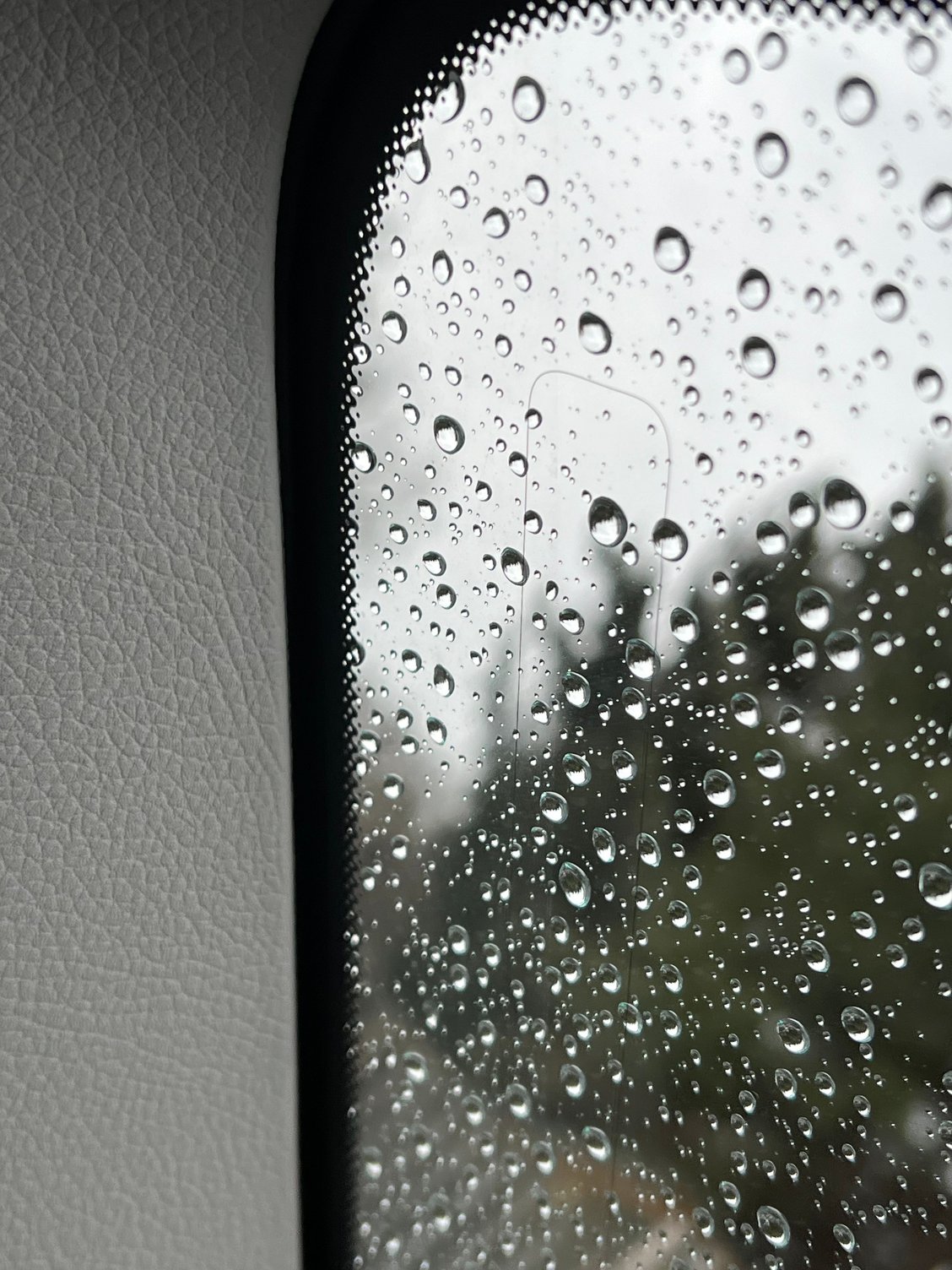

I have a 2015 SL400. Tuck the wire along the top and side of the windshield. There’s room. Then tuck between the dash and bottom of the A pillar cover. You don’t need to remove the cover.
Old Jan 9, 2026 | 05:00 PM
GTIBlack's Avatar
Joined: Nov 2025
Posts: 477
Likes: 187
From: US
Mercedes SL R231
See? You can’t see anything.

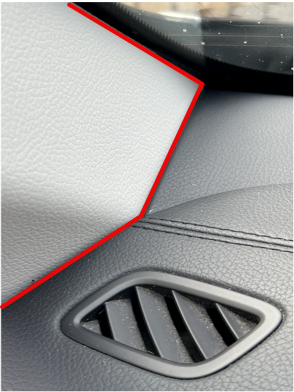

Do you have an image of wear the a pillar meets the dash?

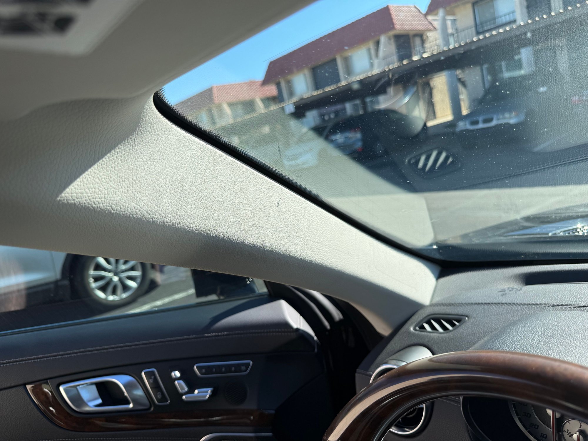

Old Jan 11, 2026 | 02:41 PM
GTIBlack's Avatar
Joined: Nov 2025
Posts: 477
Likes: 187
From: US
Mercedes SL R231
I have outlined the path of the wire in red. Using a plastic pry tool (or spudger), I was able to tuck the wire where the parts came together so it was not visible.

Its easier just to loosen the cover. If I recall, you just need to unscrew the visor and then pull. There are clips holding the part in place. A-pillar and half the top is one piece if memory serves.
Super easy to route then…

@crconsulting posted a helpful link in my other thread on how to remove the A pillars. Just 3 torx screws to remove the visors and 2 clips (pry gently) for each side. Photo in the other thread so you can see where the clips are located.
https://mbworld.org/forums/sl-class-r231/920800-insect-light-top-driver-side-pillar.html#post9236372
I originally routed same as @GTIBlack on the passenger side for my dashcam but ended up removing the A pillar and routing the wire behind it as I was getting rubbing sounds between the A pillar and dash.

where did you wire the acc wire?

what is the name of the circuit you added that pushes into the fuse slot but has fuses separate from the slot

Oh I found it " add a circuit"
