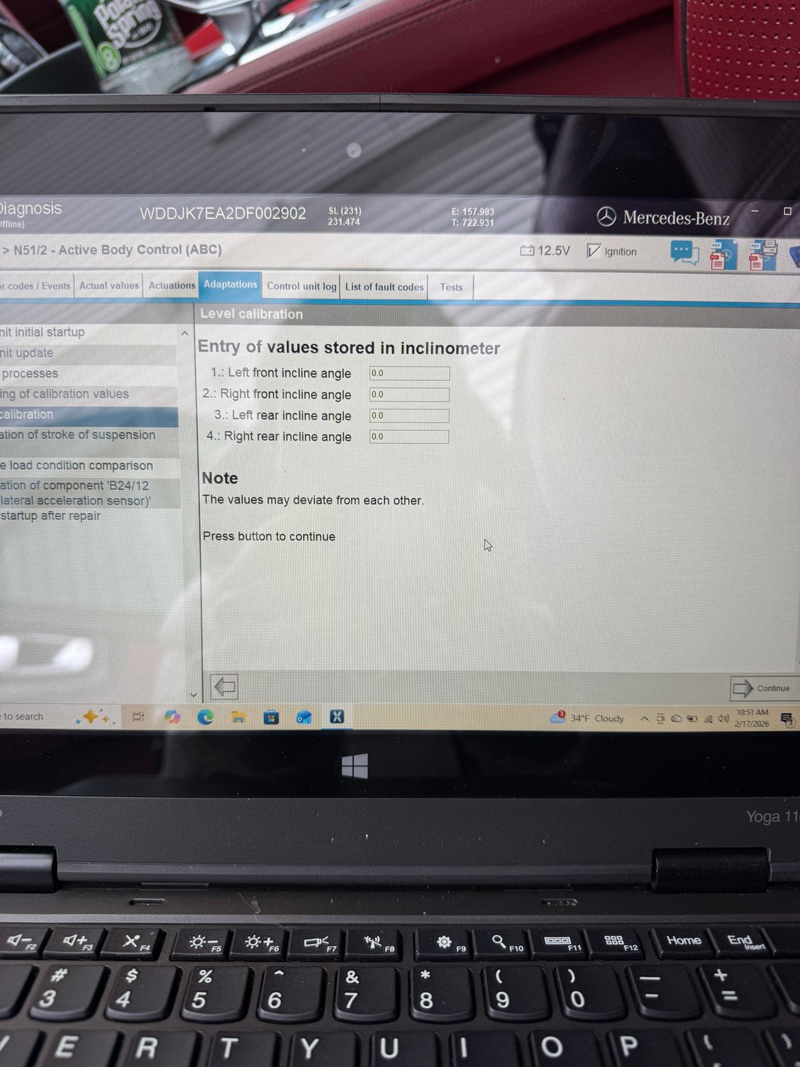

I’m just changing the ABC pump and in a second of stupidity I’ve reset the value of the sensor. Is there anyway I can retrieve these value or anyone have the factory of this value for 2013 SL63.

Just do the automatic calibration function.
