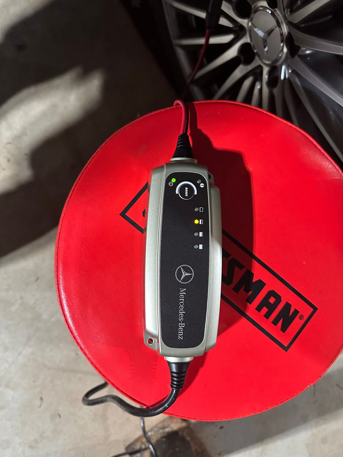

Just checked battery tender which has been attached since last Friday and it has gone down to 1/2 charge. Something is definitely draining the battery while the car is in the garage and I don’t think faraday bag is helping.
Went from 3/4 to 1/2.

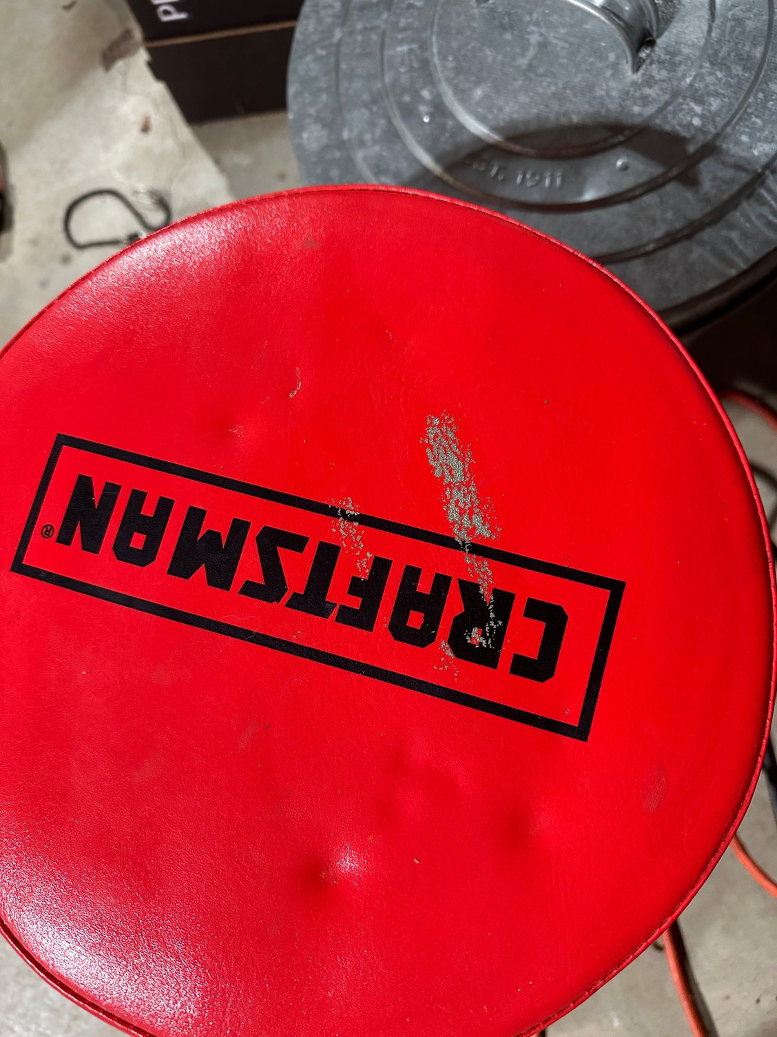

Battery tender was hot when unplugged this am. Left melted paint marks on the stool I had it resting on. Can’t be a good sign. Both service manager and shop manager perplexed. Hopefully will find out the problem by Friday.

I am following the exact procedure, with the same exact (MB branded) trickle charger. I hooked up negative to ground post, opened hinged plastic door to reaveal positive battery connector, slid the positive post door cover(inboard) then attached the positive clamp to the positive battery post(in engine compartment. Then I plug into wall outlet(reverse procedure to disconnect). When the charger completed a full cycle( amber 1/4 amber 1/2 amber 3/4 amber 4/4 then green led full charge indicator), I pushed the reset button to restart the cycle.
Then I found out that with AGM batteries, they suffer from being overcharged. So now I only go through 1 complete cycle, every other day. I don’t know if that charger is set up to provide current equal to the parasitic draw, or if there is excess that overcharges the starter battery.

my experience after the critical starter battery msg and hooking up MB tender was 3/4 amber down to 1/2 amber after 24 hrs and tender getting very hot which may indicate tender over charging battery. My original starter battery initially checked out OK while being serviced but later after electrical diagnostics were performed it failed and was replaced. Currently following the double click hide the key fob in a faraday bag procedure. Plan to get a battery tester to check periodically the charge status of new battery.

The manual that comes with the MB trickle charger says to connect the red lead first - then the black to the ground post. And reverse when disconnecting. Don't know if it will make a difference.
