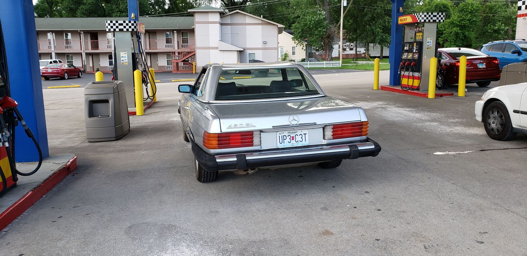

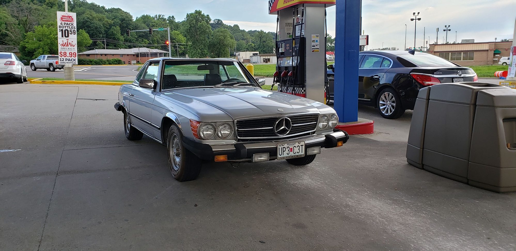

Thanks for the responses everyone! As of 2 days ago, I've got this party started:
I'm blown away by the driving experience of this car already, and oddly impressed by how solid the doors feel. Hell, it feels more solid than my 30 year younger Lexus sedan.
Going to read up more on the ACCII, since my climate control doesn't currently work. The blower fan works in Defroster mode, and will blow heat, but no cool - the fan will not blow in other modes. Sounds like an indicator of the servo issue, right? I'm also going to check the refrigerant pressure and convert to R134a if low.
