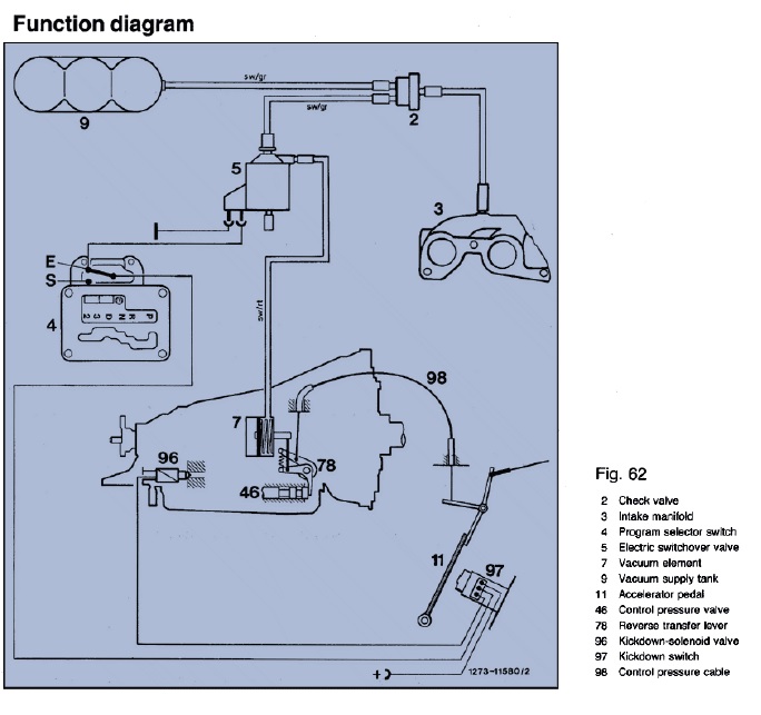

I went to remove the transmission from the car and in the process one of the two vacuum lines became disconnected on the engine side. I cannot figure out where it goes. It is the red vacuum line that attaches to the kick down cable attachment port on the right hand side of the gearbox. Where does that attach on the engine side?

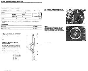

Also, I need the flywheel / flexplate torque specs for the flywheel bolts. Does anyone know?

Here is the vacuum diagram, looks like it is connected to a vacuum solenoid somewhere.
Also info on the flexplate mount.

Thank you. I think I found the vacuum port. Also big thanks for the flexplate info. I DID NOT know about the alignment of the two holes thing. That would be a nasty surprise.
