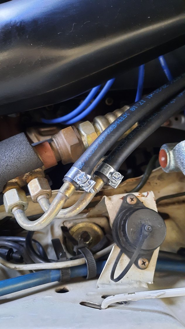

Looking for part numbers
Hi all,
Hoping someone can help me find the part numbers for these two fuel lines. The two split one in the centre of the pic.

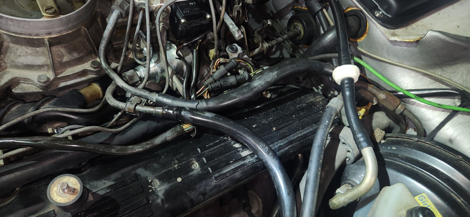

Based on your picture it looks like you have a 560SL. The supply line from the chassis pipe to the FD may still be available, I found one for my 380SL at FCP Euro. It didnt fit properly so I returned it. I ended up replacing all three lines ( supply and the two returns) using new fuel injection line hose and high pressure clamps that I got from BelMetric.
https://belmetric.com/m7-3x13-5-smoo...3hp-2240-0600/
This worked great and cost less to do all three than the single hose from FCP Euro did.
