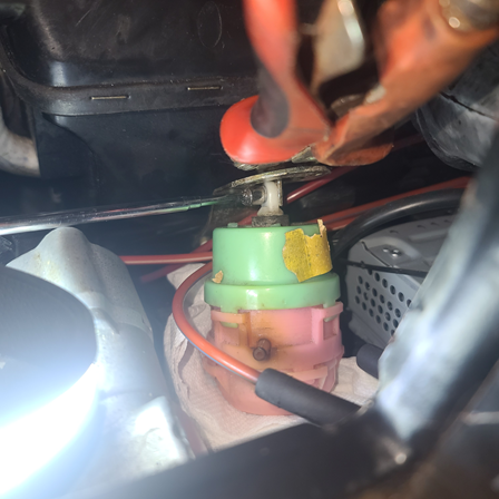

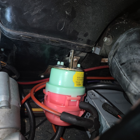

4 Take a small vice grip and lock down the rod that is attached to the defrost door.
5 disconnect the vacuum lines. The bottom one is red with a white stripe the one on the side is red with a blue stripe.

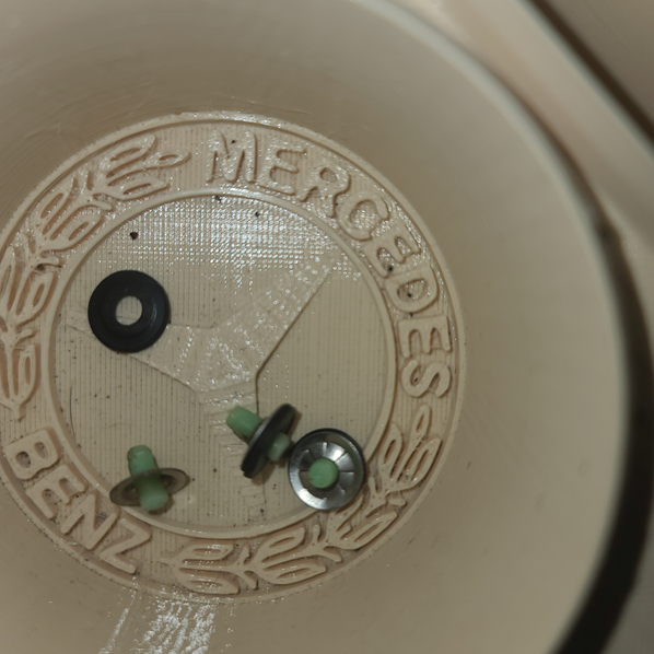

6 then i sharpened a long flat head screw driver put it in between the top of the vacuum element and the bracket, tapped with a hammer to gain a little room. Then from the same position I broke each one of the 3 retaining pins. Pull the pins out with the rubber washer and retainer and save to reuse later. I also PUT A PAPER TOWEL under while I was working so if anything dropped I could find it.

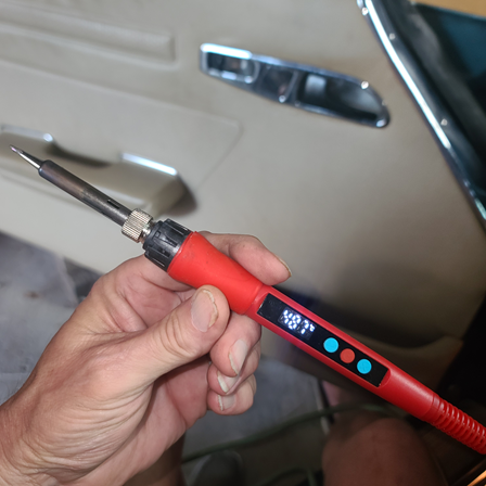

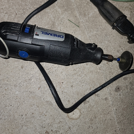

7 This is where things got really challenging. EPC shows that the pin that connects the vacuum element to the rod is held by an c clip. IT IS NOT. IT WAS A RIVIT. By this time i was fully committed. I used a soldering iron to melt the plastic around the pin and then used a Dremel with a cutoff wheel to cut the pin in and remove it (after trying many other ways). That worked well.

9 Then take off the vice grips holding the arm. I then pushed the broken pins thru the retainer washers with a punch on my vice very carefully.
10 Then push the vacuum element into the bracket and while holding the element push the rubber washer and retainer on top of the plastic pen. once you get it started i used a screwdriver and needle nose to push it until it was fully seated. Then repeat for the other two pins.
