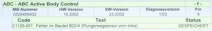

I too am recently having ABC errors ("ABC! Visit workshop!" in the malfunction display). Restarting the car clears the malfunction. I had the dealer look into it and thet determined a malfunctioning sensor in the ABC strut (left front). The ABC strus seems to be working fine, the problem seems to be the sensor in the strut (which cannot be replaced) which requires the while strut to be replaced (€1200 for the strut + labour == €2.000 for sure). Rear struts have both been replaced on warranty in the past.
I've attached the error from star-diagnostic. Does that look like your fault?
About the letter, I have no idea. The dealer should be able to tell you what they are going to replace.
