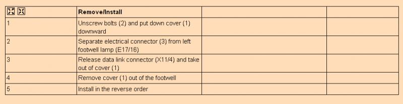

I'm trying to remove the gas pedal from the SL to install a sprintbooster unit for it... But I'm having trouble removing it. How/Where on the gas pedal to we loosen to take it out?

Here are some screen shots from the WIS:
Here is how to remove the panel:
Here is how to remove the pedal:
Hope this helps
