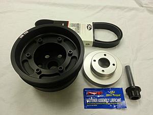

I have bought this small supercharger pulley from Eurocharge and will perhaps at a later point upgrade with a bigger crankshaft pulley.
Right now I am doing a work over on my engine and had a really hard time disassembling the standard pulley for changing the front crankshaft sealing - I have the engine out of the car and can just image how difficult it will be with the engine in the car …….. so I am considering buying this Mercedes Benz Engine Crank Pulley Belt Set with changeable various outer sizes and would like to hear if anybody have any experience with this kind of set-up?
Attached Thumbnails Changeable Crankshaft Pulley Size-changeable-crankshaft-pulley-size.jpg

decide on a goal first. the clearance on the water pump pulley is tight, so if you decide to go bigger later you will be buying a new wp pulley also. you would need a new belt too. add a new tune. so basically you gained a crank bolt.
decide on where you want to end up and head straight there. if not, lots of money and time go down the tubes.
