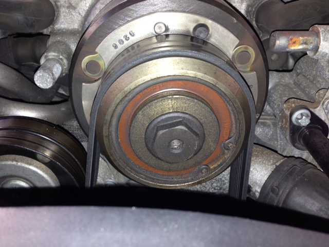

here is a picture of clutch bearing, for me it looks good. What do you guys think?

if you loosen up the idler right next to it and remove belt you can spin it by hand. listen to it and see if you hear any clickity clicks going on. if you do, good chance the bearing is on it way out.
i would not use any type of belt grip spray. it is normal to have the chirp when it engages. mine went away once i did the smaller upper pulley though. i may be going a different route and have it for sale soon too. only a few hundred miles if that.

Today i removed the belt and spinn it and dont hear any mystical noise.tthe noise doesn't bother me so much. What do you guys do if you have the same issue??
