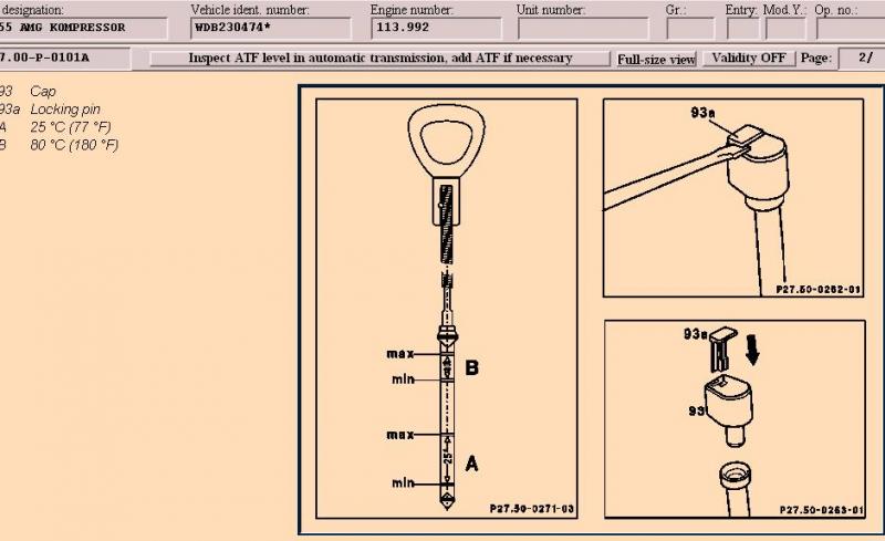

The tube with the locking tab is for ATF.
If you plan on doing your own work join http://epc.startekinfo.com/epc/welcome.jsp its free, it has all the part numbers and exploded views.
I would also get a copy of WIS for service information and repairs ( check ebay.)

Thanks pjg for all the information - yep, the one BEHIND the right head valve cover IS the fill tube for the ATF.
Gary-
