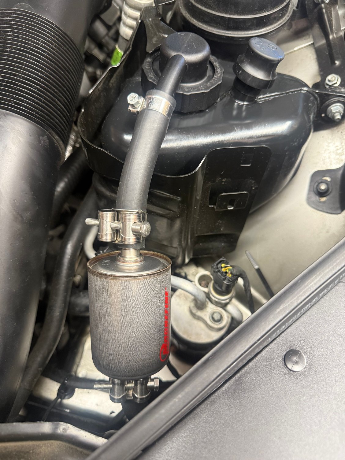

No picture is necessary. Starting at the ABC reservoir, I installed ~2" of a 1/2" reinforced rubber hose using the OE clamp (you could cut off ~2" of the OE hose, but it's going to be a real tight fit, and I wanted something that would allow easy removal of the Magnefilter if/when I wanted to replace it). Then, I slipped a 1/2" Norma clamp on the hose, and inserted the 'out' connection of the Magnefilter and tightened up both hose clamps.
Then, I marked the OE hose coming up the front of the engine bay where it would fit best on the inlet side. Cut the OE hose there, and slipped on a second Norma clamp, inserted the inlet nipple into the hose (it's gonna' be tight) until I got it nearly to the enlarged filter part. Tightened both Norma clamps and checked the fluid level - it was at correct level. I checked it again after a few minutes of engine running, and the level was still OK (engine 'aus' in both cases - for at least 15-20 minutes).
Regular hose clamps would probably be OK, but I like the Norma type, as they - like the OE clamps do not have any open 'slots' to cut into the rubber.

I did the install and swapped in a new OEM MB filter as well. I'll let this setup perk for a bit and then fluid swap, my existing appears to be in good shape but I do want a fresh start. That hose is joy to work with, I broke a cap getting it off and then had to warm the hose up to get the magnetic filter in. Yes I like beefy clamps lol but that fit is so tight you really don't need them.

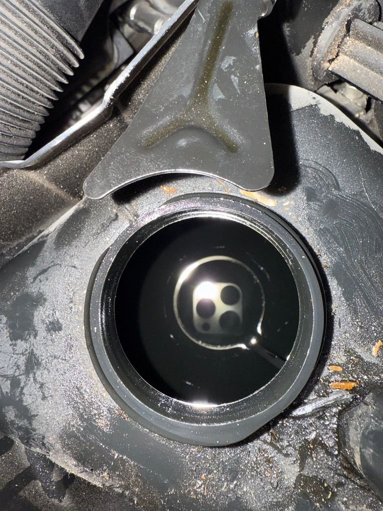

I just did the fluid change..... 1st time in 22 years! I bought the whole lifetime fluid thing.
Fluid was black (hard to believe). It took about 20 mins and 7 liters before it turned a nice clear, green.
The whole process was pretty easy.
