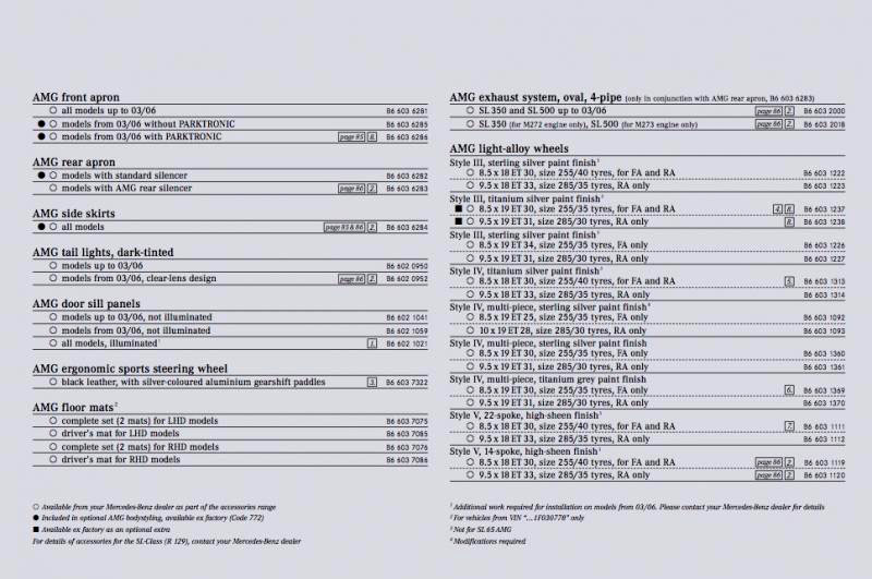

I have the 10" version on the rear of my SL55, was very lucky when looking for 19" SL65 wheels that these were the only ones available at the time.
Refer to attached JPG for AMG wheel options.
